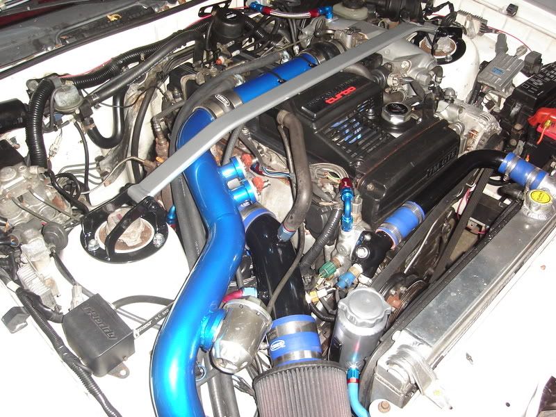

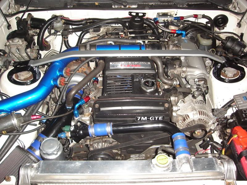

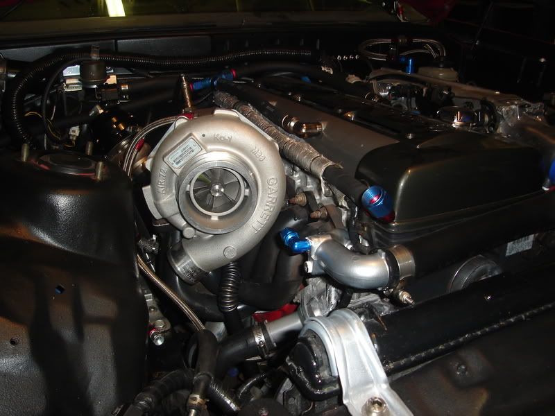

i replaced the blown 60-1 ct26 with a 57 trim ct and powder coated some thing's to clean it up.i'm done with it for now though.my 2j car is getting a garret gt40 and a new custom intake plenum w/80mm tb.i'm also doing some new ic pipe's for clearance,bigger radiator need's more room.i also got another set of rim's for it.
the 7m engine bay now
the new haidryer(comp cover is polished now)
no new pic's of the mani,just the lower runner.the surge tank is almost complete,just need's some finished welding.
