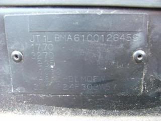

Too crappy a pic to tell from that.
G282 = 4.30:1 89+ N/A Non-LSD
G284 = 4.30:1 Pre-89 N/A Non-LSD
G285 = 4.30:1 N/A LSD
G305 = 3.73:1 89+ Turbo LSD
G315 = 3.91:1 Pre-89 Turbo LSD
A stock N/A with W58 and 4.30:1 rear end will be doing about 65MPH at 3000rpm in 5th gear.

so these numbers would be in my vin?
i guess my speedometer is off then cuz it shows 60 at a lil over 3k....i guess that explains why it dont work anymoire hah....

in that pic it ends with 303W58 so i dunno what that would be..... turns out mine is is 315R154 so thats the 3.91, i must have just had bad info last time i checked.

Jeff Lange said:
Looking at it closer I can see what it is. It's a European MK2 Supra.
F303 = 7.5" 3.73:1 2-pinion clutch-pack LSD.
W57 = Tranny
agreed. the MA61 gives that away...
