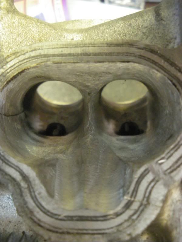

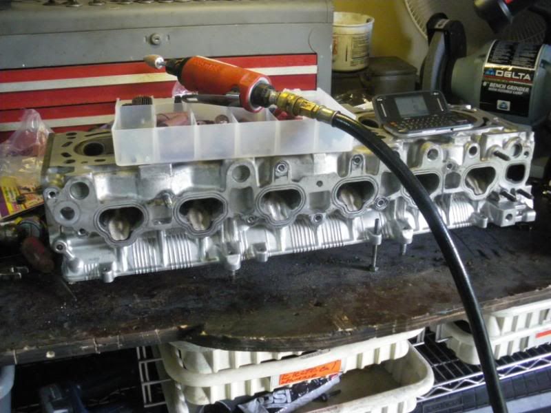

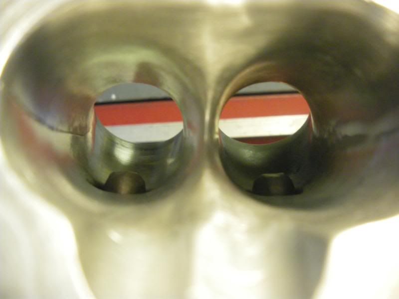

so yesterday i got the time to go pick up all my stuff (head, old block, etc)from my friends shop.

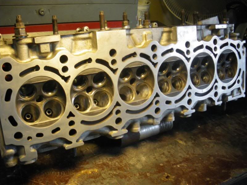

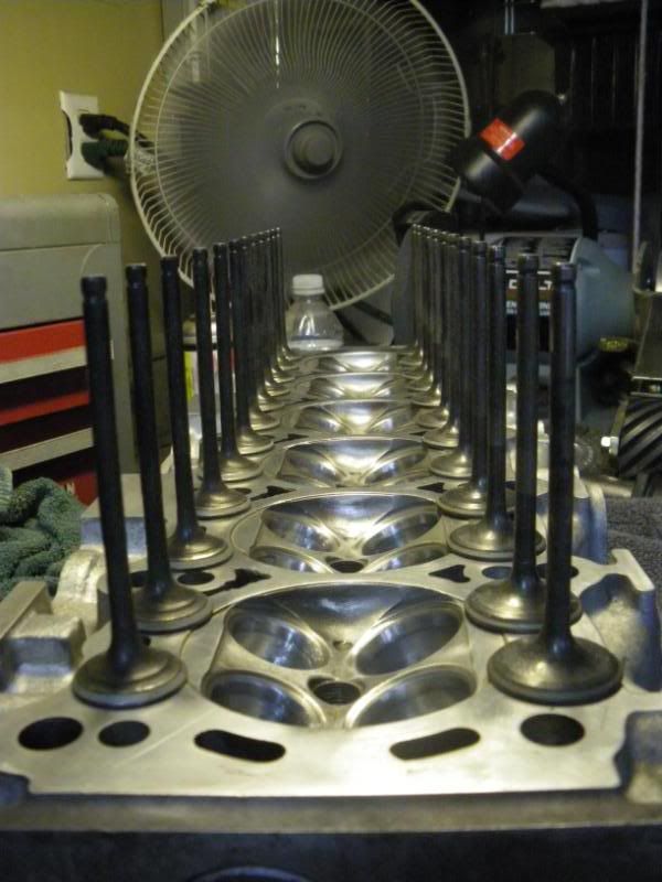

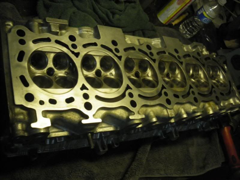

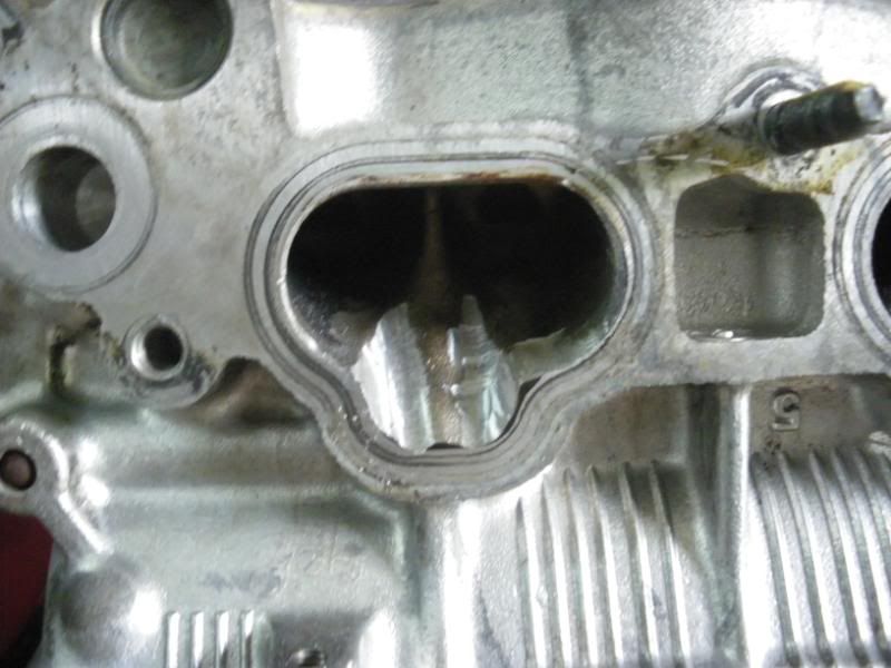

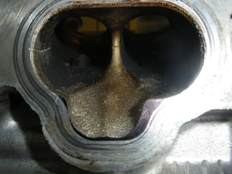

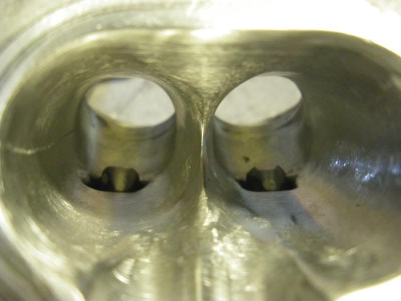

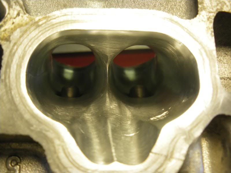

and today i got off work early so i decided to tackle the port&polish. i have a whole new respect for people that do this for a living... now i know why it is so expensive!
so yea its gettin there. i still got some work to do on the exhaust side but its nearley done.
heres before and after:
i think it will flow a little better (;

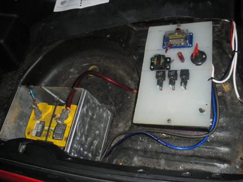

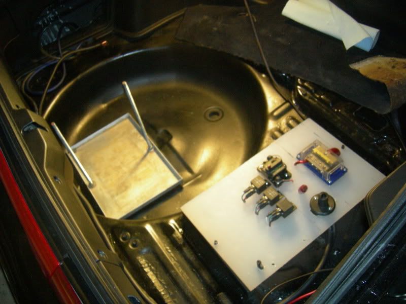

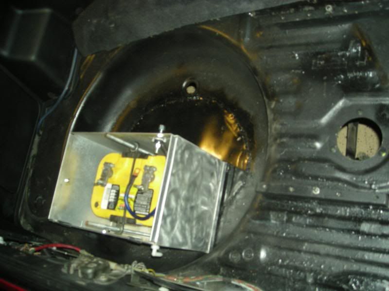

so i got some of the wiring done today, built a little power distribution and fuse/relay panel to go next to the battery in the trunk. ill post some pics up tomorrow if i get the time.
also should have the mockup block and head in place soon so i can start fitting all the new stuff. maybe ill put my new welder to use! (;

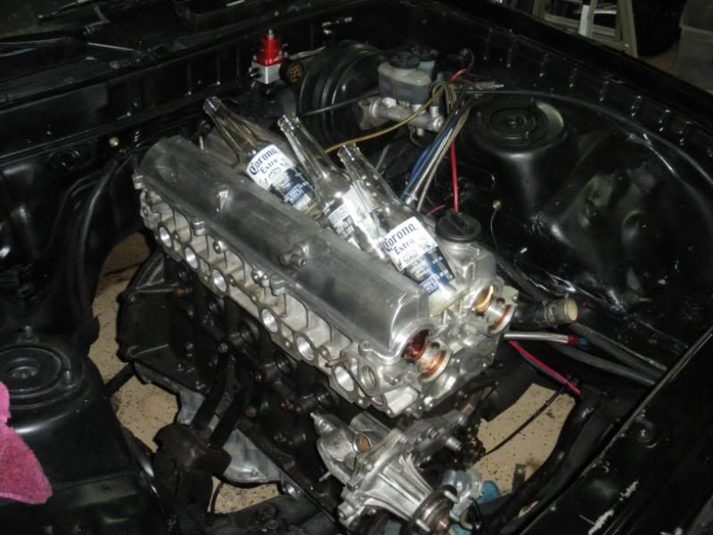

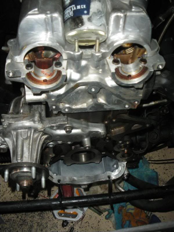

ok finally got a little more time.
i got the mock up motor in place. i actually had to do it by hand because my cherry picker broke! so i put the just the block and oil pan in first then the head. yea it wasn't the smartest thing to do but i got it done and didnt scratch and paint.

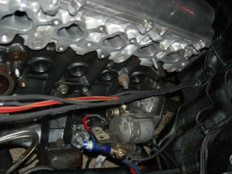

heres what i did so far for wiring up the power for the car,
i have some more goodies coming in the mail to finish that up but you get the idea. when finished everything will be cleaned up and tucked away..

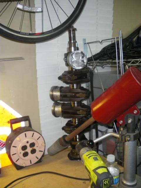

i think im missing some stuff here what do you think? lol
my old rotating assembly serves as a cool decoration for now.
let the mockup begin!

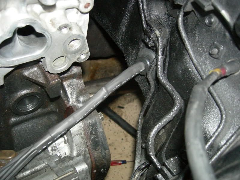

I got all the wiring routed now and have started wiring up all the go-tech stuff. It is supriseingly simple. I am very happy with it so far.
I put a new hole on the intake side in the firewall for most of the harness to go through so it doesn't have to be seen going across the top of the firewall. It is coming out super clean, the only wiring that is going to be visible on the intake side is going to be the injector leads and the TPS wiring.

the wiring harness pulled through the intake side of the firewall,

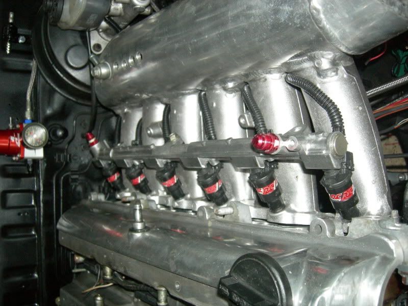

injector wiring,

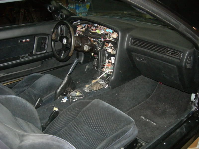

i was tired of seeing my interior all messed up and dirty so i cleaned it up a little to,
anyways, slow but steady progress...

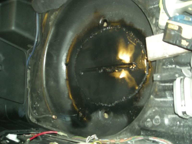

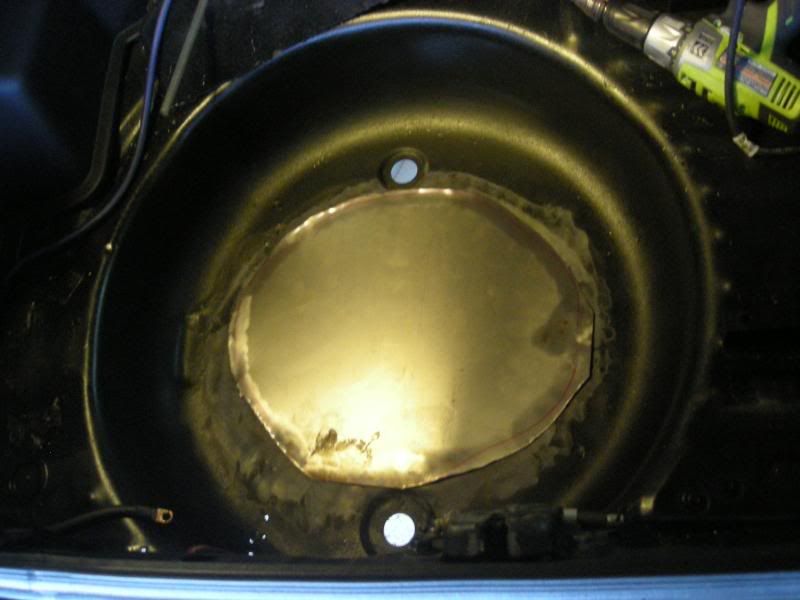

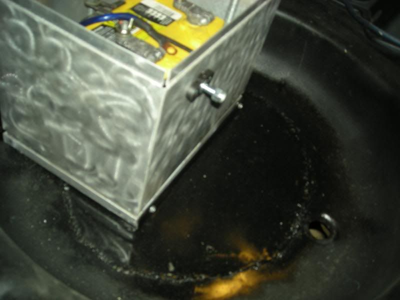

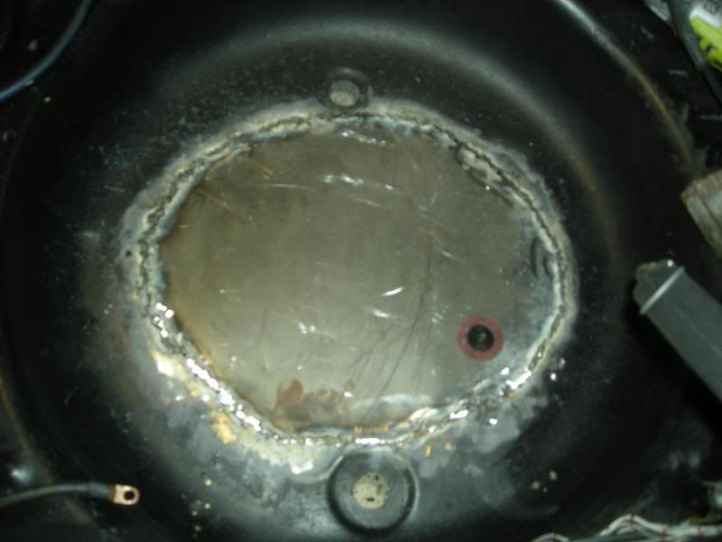

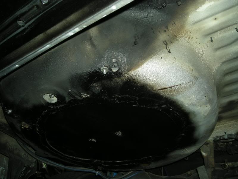

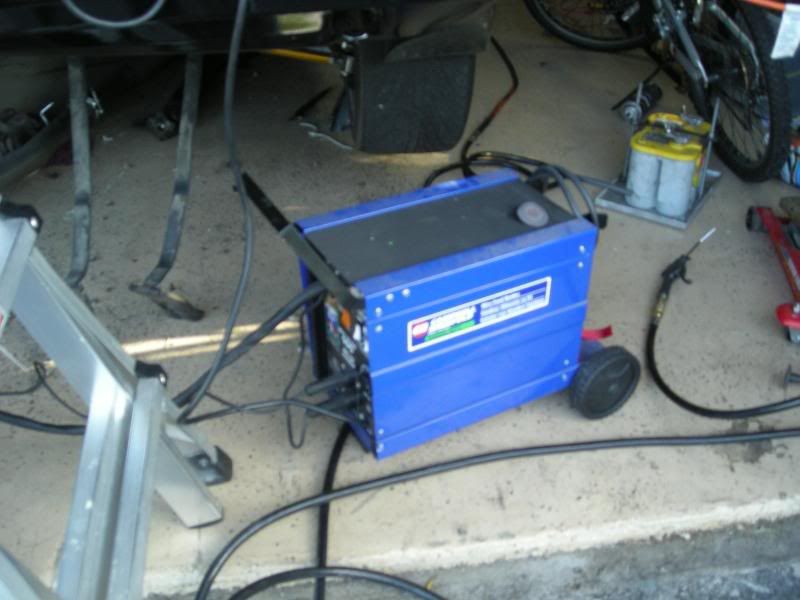

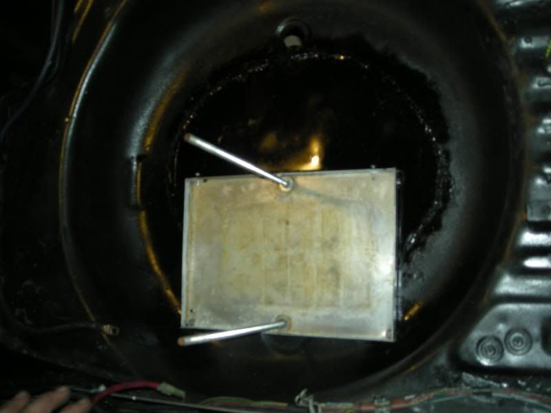

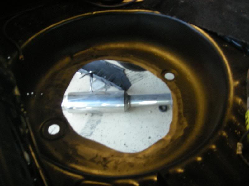

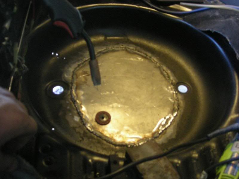

ok, did a little cutting and welding today!
I decided I wanted to make the rear tire well flat so the battery box would sit level and nice.
the welding didn't come out perfect but it wasn't bad considering u was using my little mig with flux cored wire.
