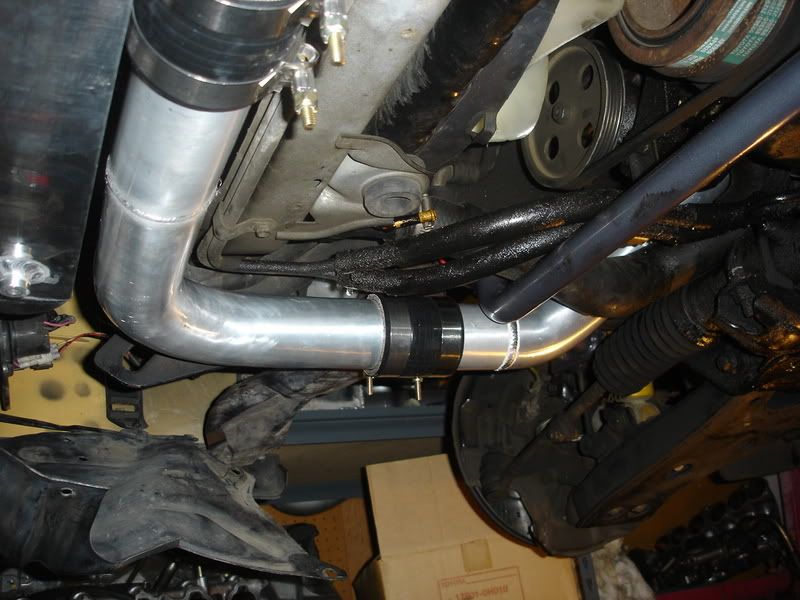

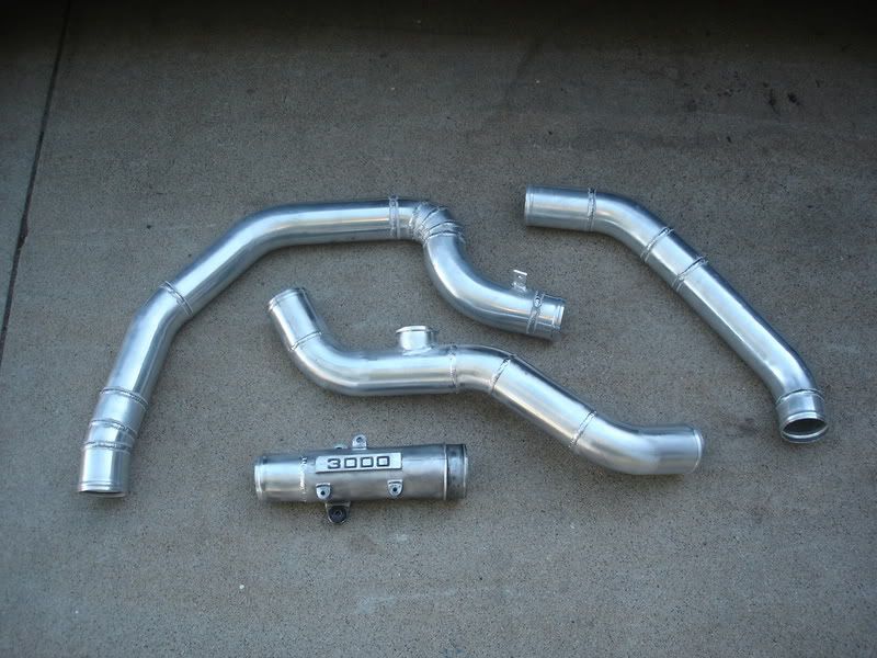

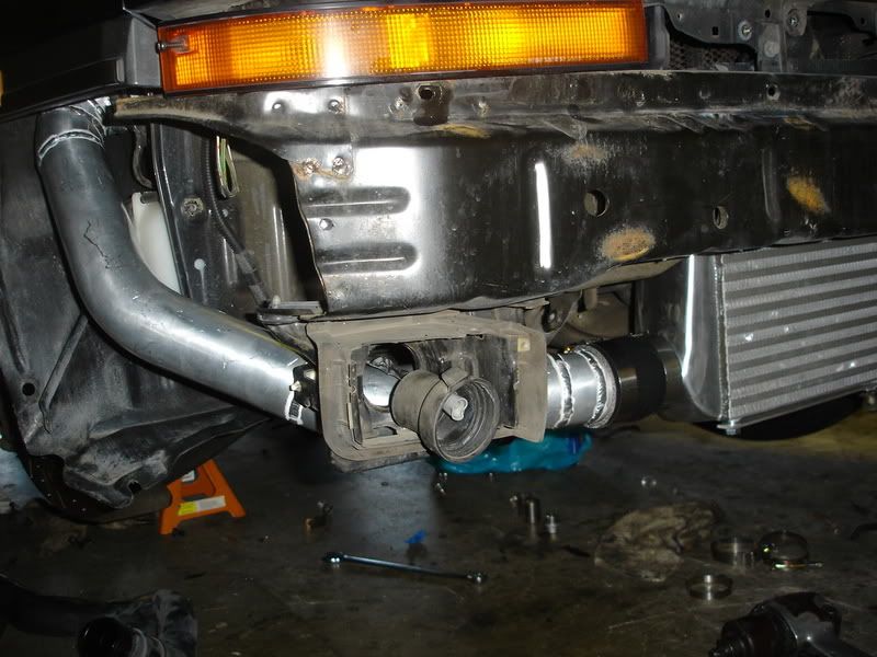

there are a few reasons for the cupplers insted of welded pipes,
1.(main reason) to keep costs down so i can pass the saveings along to you.
2.smaller box = cheeper shipping
3.i think nice cuplers look better than a bunch of welds.
and im going to look into how much more it would cost me to do beveled ends. it is still a posibility.

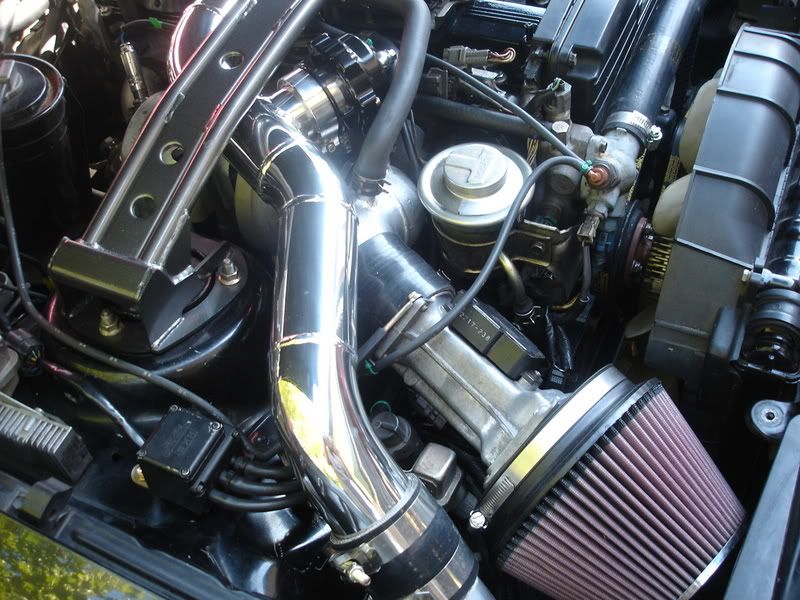

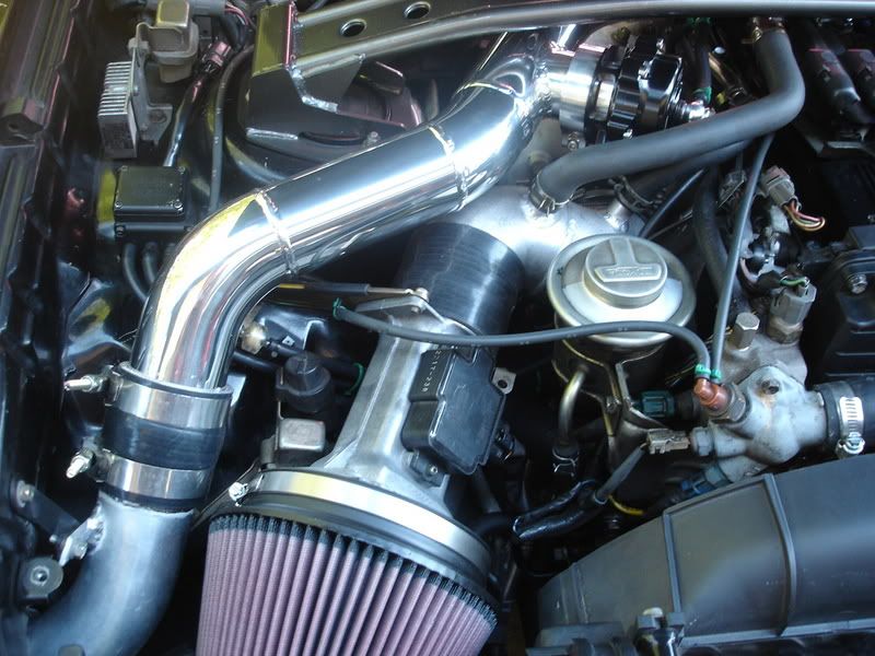

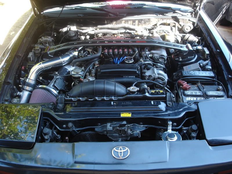

:rofl: :rofl: :rofl: :rofl: I almost fell out of my chair after reading this thread and looking at the pictures! Lets see here, you are basically selling an ebay universal piping kit and just cutting it to fit for people. No bead rolled ends, no t bolts and what look like rubber couplers. Too damn funny. One of your selling points is that the couplers look better than welds? At least its not as bad as the guy trying to sell home depot radiator pipes for $50.
Let me show you what a real piping kit would look like.

you have no clamps on your coupler to the AFM... and where did you get that strut tower bar?
thos IC pipes aren't bad, they're better than cooleeze because they actually bolt in like the stock ones do...
Give the guy a break, if they're cheap enough and fit fine it's better than hassling with the universal sets and still needing pipes...

Im aware of the clamps missing on the afm,lol. I took the picture when test fitting. That strut bar is a TRD for the MK4. The list of reasons why they are better than cooleeze pipes goes far beyong the mounts. The main reason Im busting this guys balls is he is claiming to sell a kit when in fact it is simply a universal ebay piping kit that you can get for around $100. Wow! he cuts the pipes for you! Im sick of seeing people who are just trying to make a quick buck with minimal effort.
