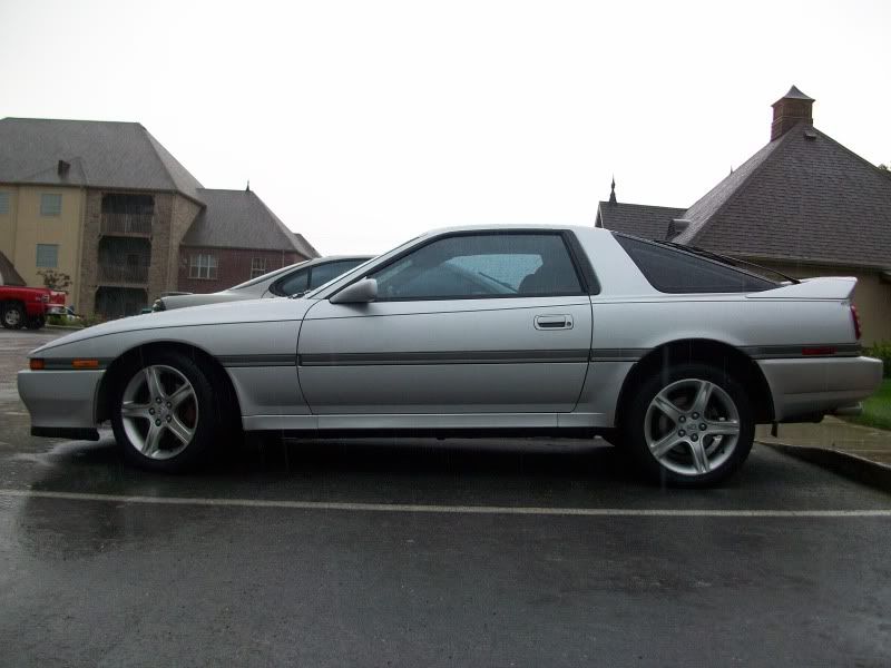

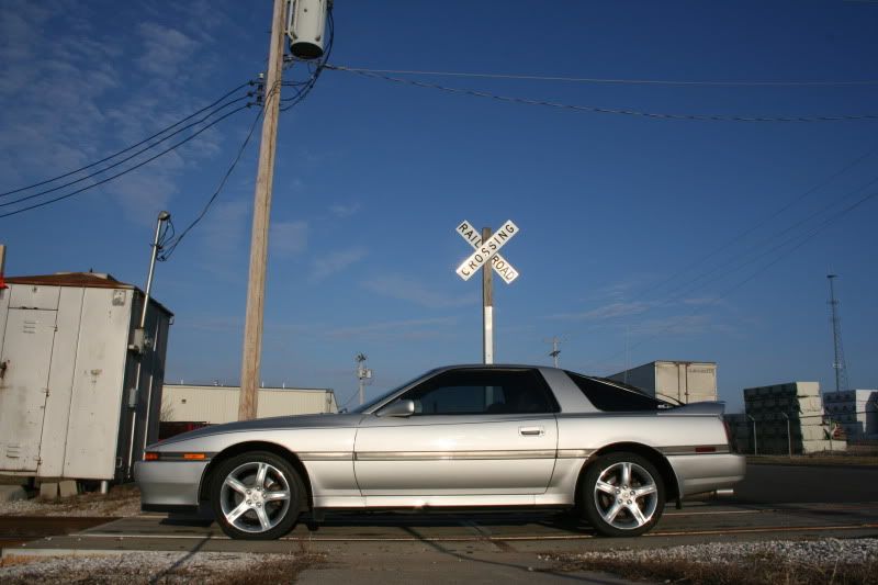

PICS! Here's how she sat a few weeks before. Stock everything except wheels.

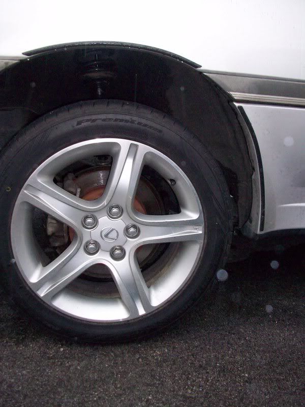

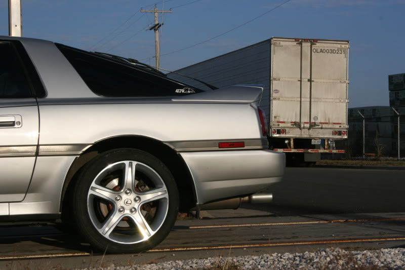

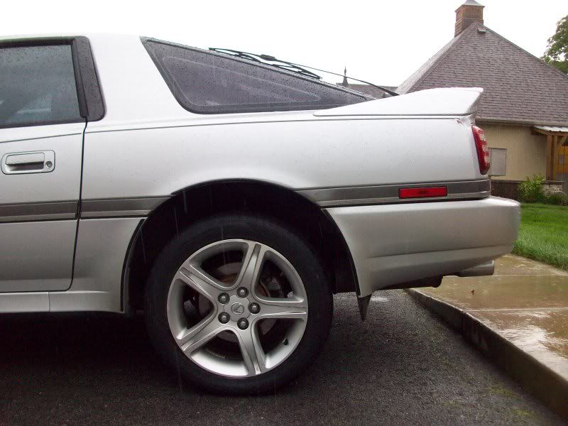

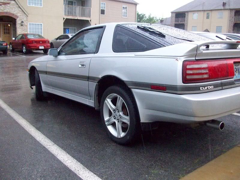

After, today, lookin like a truck. DonkasaurusREX!
It really does look a lot worse in person. And this is after about 6 days of being finished and driven..

Looks like the front is in the rear and vise versa. Take some pics of the rear spring.
