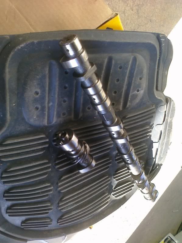

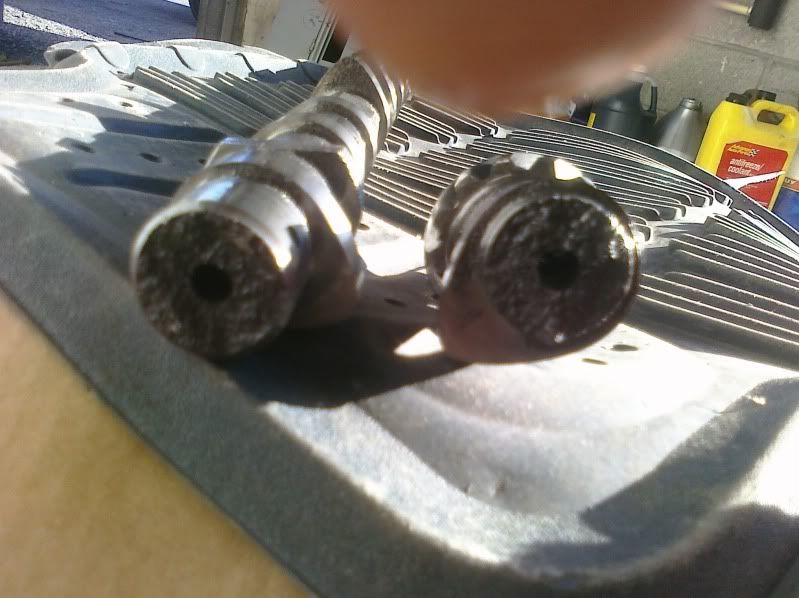

I couldnt take real pics because my camera is MIA but i did take a few quick snaps with the camera fone....and i called BC earlier.
Any ideas?

Sorry Ian, like i said i cant find my camera and i took pics as soon as i took them off. I'm just gonna send them out to BC if they dont want to replace it i will just buy another one...I need to get this car back up soon.

That sucks about your cam. I ordered some BC 272's for my 1J a few years back and had a cam break just by sitting in my garage over the winter. I called them up, sent them some pictures, and they were able to send me a free replacement within a couple of weeks. Hope all goes well with your return.
