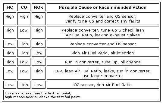

suprajztwenty
Nov 5, 2009
369
corinth tx
this cheat sheet has helped me greatly.
