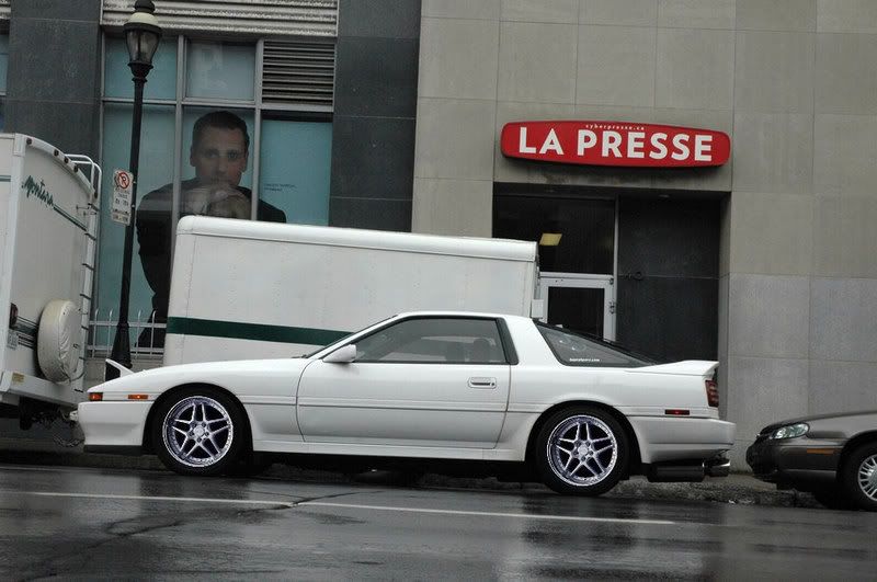

after a year of not having one supra on the road I need boost back so "Project Fix the Piggy" has officially exited hybernation mode. I have to sit down and plan exactly what's going to get done this winter/spring and what can wait. I've started buying all the parts I needed including a set of wheels I wanted to share with y'all.
For about a decade I've always loved the Blitz Type-03 but they were always too expensive. RB had a set a couple of months ago; I still wasn't convinced they would suite the car. My friend did a quick photoshop of the rims on my car...2mins later I bougght them :). The cool thing is I have about half a dozen MK3 1/24scale models and about 4 sets of 1/24 scale Blitz Type 03's...so I can pretty much build a duplicate of my car in 1/24 scale :).

George, you know how i feel about this project. Those wheels are going to look awesome on there, they look so good in person.
He's holding out on you guys though. That isn't a normal HKS sport turbo...it's had some modifications done. and you must understand that dyno was with no boost controller. You should have felt the thing at 14psi!
can't wait to see this thing finished. you're just some labour away!
