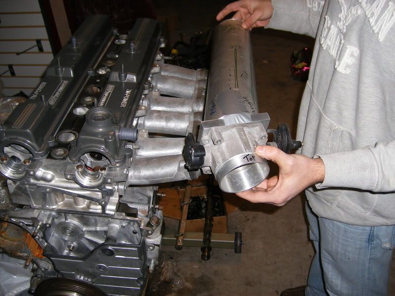

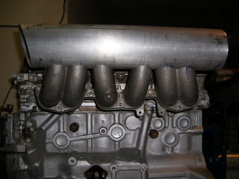

I'm no expert on plenum chambers but why so much over hang past the number 6 runner??

Enraged;904716 said:
have you tested it in the car? im not trying to be an ass, but my ffim is of similar size, and mine was VERY close to hitting the hood. just something you should be aware of.
Welp here is a good example. (sorry badboysupra for stealin your pic)
Here is a stock setup....
and here is my setup...
it actually looks lower, but i went the safe route and said it was a 1/2
"higher!!! Now does that convince you that its gonna clear the hood!! :). ill have pics of it mocked up in the car later on today.

Good idea. The short runner adds top end, at the expense of the bottom. Especially with the oversized plenums.
Something wrong with the stock unit?
Nothing wrong with the stock unit, this really cleans up the bay, and gains more power!, Easier IC pipe routing, and alot LESS piping also :)

FFIM do not clean up the bay. That has to be the biggest false justifications I know of. It is an opinion. And I have lots of those too.
Adding top end with shorter runners and a larger plenum so as to not starve the engine when the valves are only open for micro seconds is why it is done.

zachm611;905398 said:
i would say it would save pretty close to 2 feet lol. just a guess though.
At least that much and, no fender pipes with 6 curves to deal with. Probably loose a bunch of couplers as well.
How about the EGR? any provisions planed for that?
