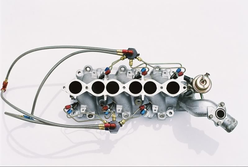

BTW before you tell me that the lines SHOULD be the same length, understand that im working in the valley of a V-6 nissan with fuel rails, injectors, valve covers, and an upper plenum to deal with. I did the best i could.

Nope. The nozzle isn't exactly open anyway, and the N2O tank will be holding a LOT more pressure than your intake will. (If not, it couldn't inject any N2O/fuel into the intake under boost, right?)
Edit: ZFast: Nice intake. Looks like she'll run like a scalded cat.
