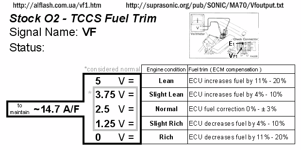

Have you drilled out the access to the bypass screw on the lex afm housing?
Screw that screw all the way in.
Check your VF
You'll be fine with 3.75V at idle. Check your cruising should be 2.5V
Don't worry if your 3.75 is 3.25 or your 2.5 is 2.25 just look for that range. There are five.
Check out the url's at the top of the image, they have good information.

Cheers for the Vf info, it's something I hadn't seen before.
I'll pass it on.
Slight problem with checking the cruise one tho, as it has to actually be able to move properly first :p
