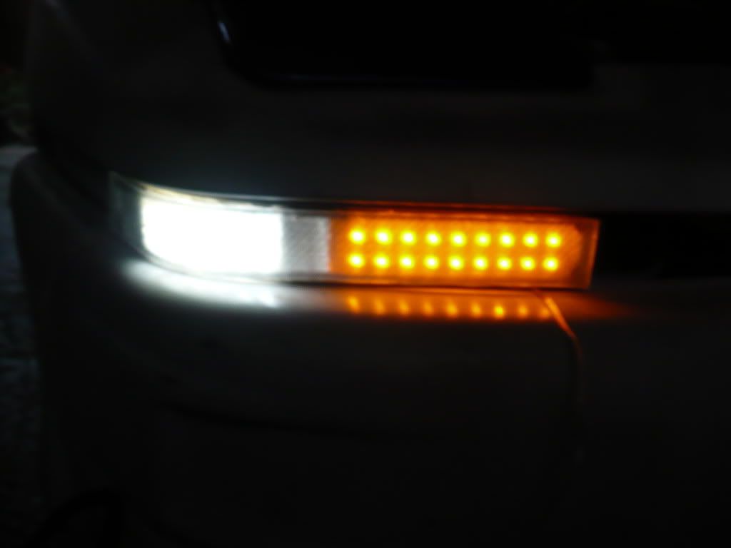

Yep need one of those still. I am getting some more electronics to make some more pwm for the dimers and the regulators too. I make the pcb out of bread board and just solder the joints with high tin solder, its a pain to work with but very strong when it cools, just gotta make sure to do it right the first time because reheating this stuff is almost impossible, also it takes very high temps to just use it so I am going through solder tips like crazy, so I need to get a cheep place to get them from as it takes me one tip to make each set of turns. It will be dark in a little bit and I will get pics of the marker lights that I have made and the turns on the car and how bright they are. I don't think I am going to use the 45k mcd white leds any more as they are way too bright so I am going to try out some of the 22k mcd ones to see if there more reasonable.

Well I can't seem to get any night pics of these. For some reason my camera really does not like it on any setting I try except with the flash on. I was messing with these for so long trying to get a pic I forgot about getting pics of the running lights.
