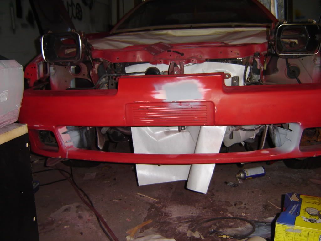

i've basically just been doing prep work as its waaaay too cold to paint. cut out the grille in the stock bumper. just gonna see if i can finish the scuffing today so i can clean up and then its just playing the waiting game for the weather.

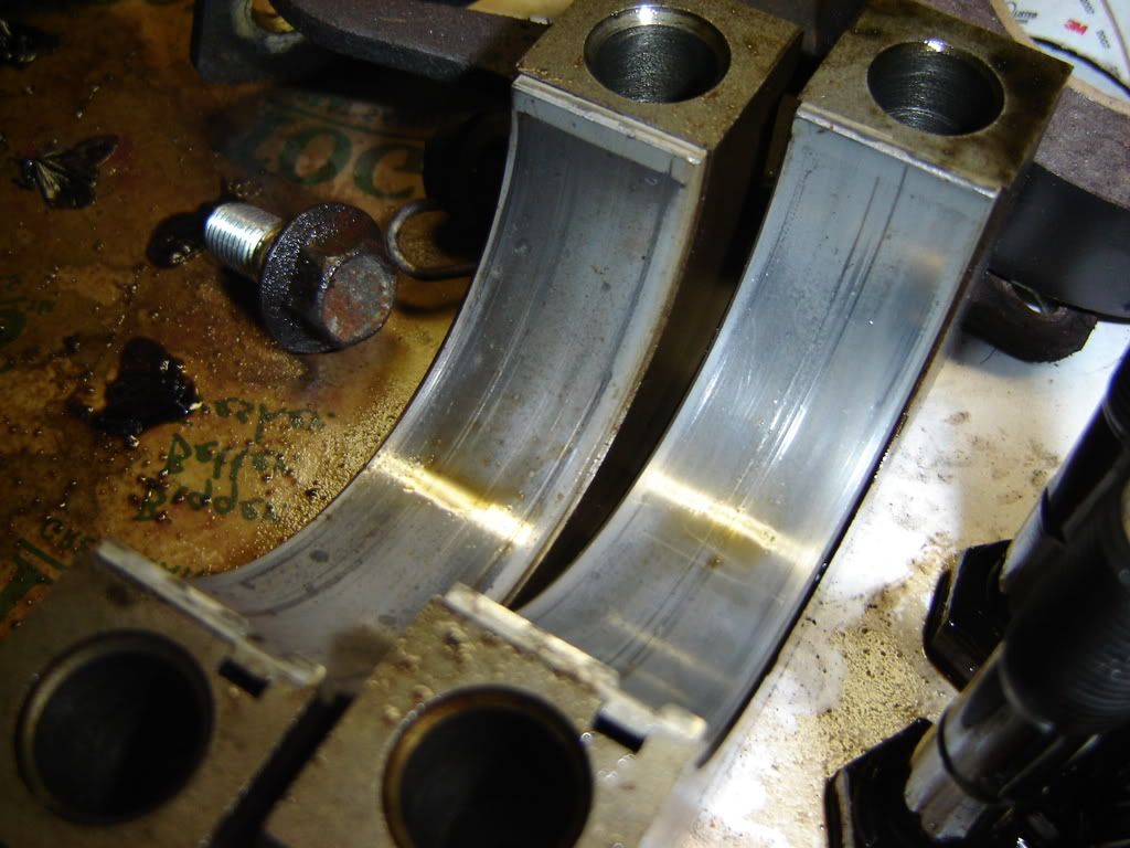

so i measured the rod journals and the cylinder bore.
cylinder bore is between 3.2675-3.2685, well within spec.
rod journals are 2.047 all around. didnt get a chance to spec the rest out but so far, im thinkin this is a very low mileage engine that a previous owner swapped in, had problems and thought the motor was on its way out. on to some pics. also included is the custom hackjob i did to the front bumper. ill be adding some type of lip to it before paint, just not sure which.

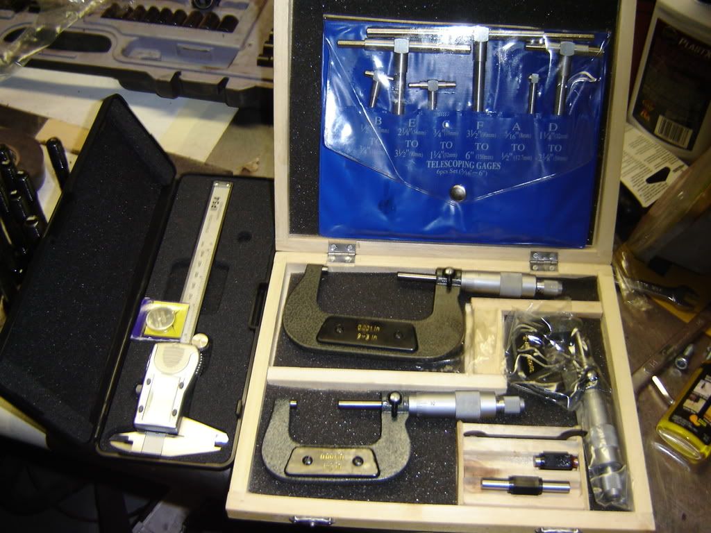

the tools i got at a local Wholesale Tool, got the micros, caliper, telescoping gauges, gear puller, 4ft straightedge, and some dust masks all for less than $100.

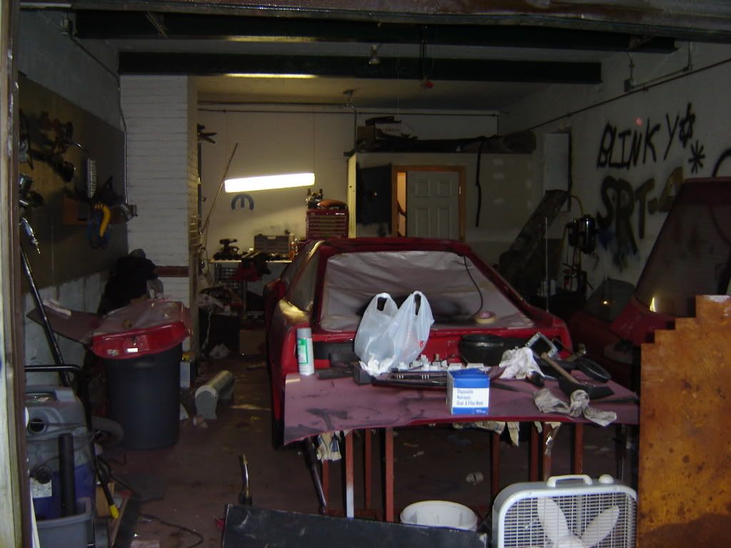

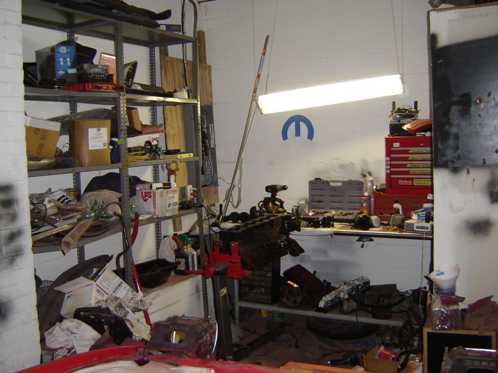

this is the mess i call my workbench.... i can wait to finish this car so i can clean up the place.
the rest of it
2 of the main bearings. how they look?
