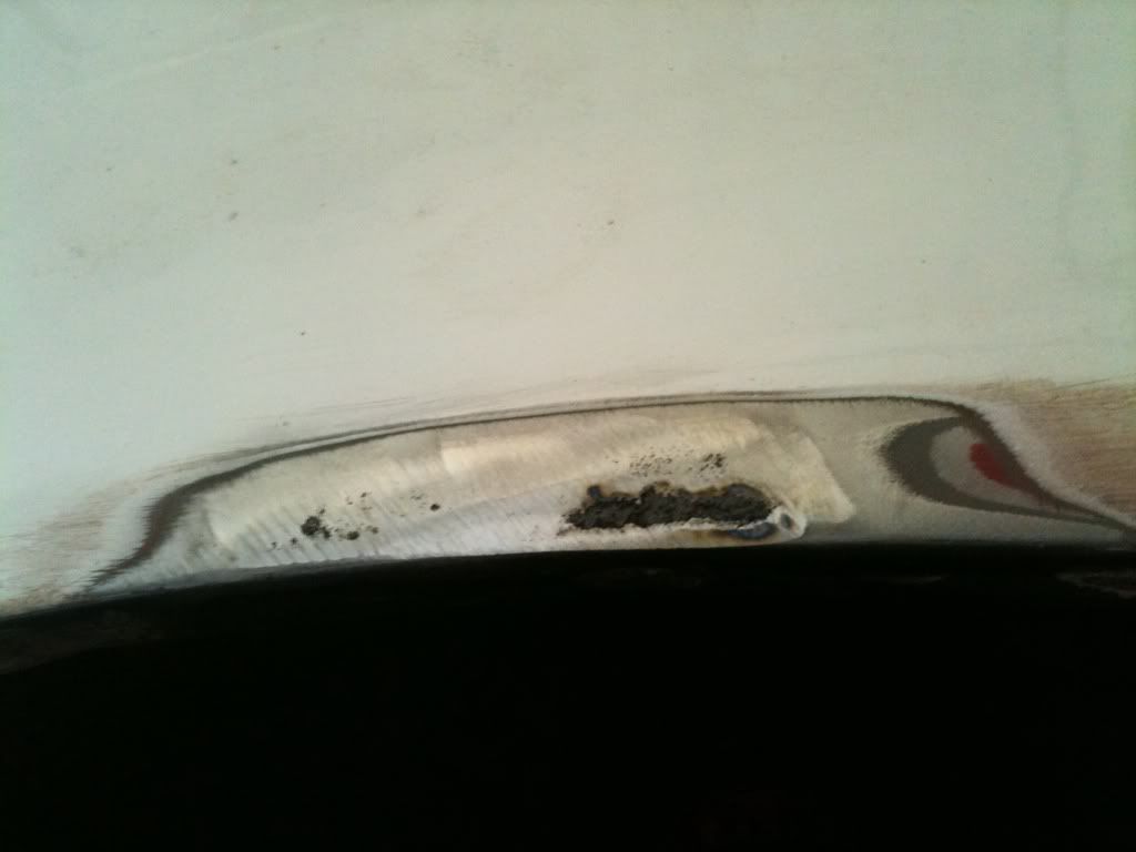

Then i wanted to see how bad the rust on my quarter is, theres only a little dime sized paint bubble. I know that rust is like a cancer and for every bit you can see there's 10X's more you can't see.
I start sanding the paint off and i get down to the bare metal in all but 2 little spots, so out comes the angle grinder...

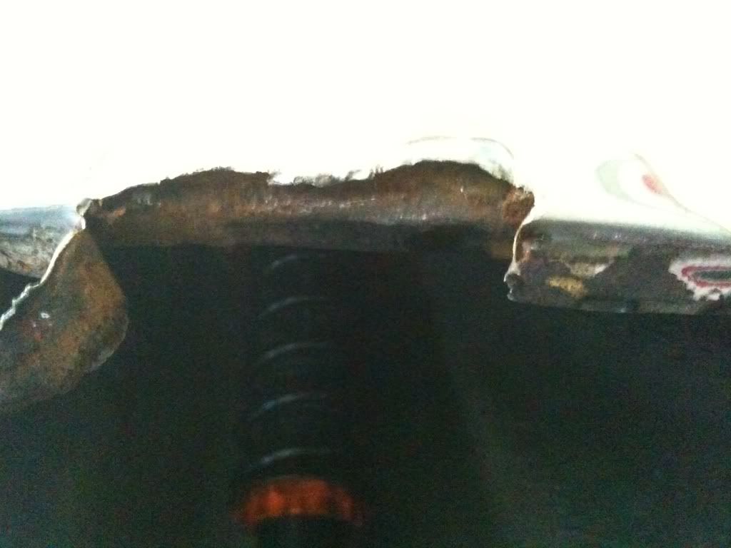

Finally i realize im no longer looking at rust, but the foam "sealer" toyota decided to use on the wheel wells when they put the quarter panels on over the wheel well. so i go at it with a screwdriver to see the extent of the damage. Needless to say i'm very dissapointed. I just painted this friggin car!
Oh well, just something else to fix, this car is gonna be mint by the time i done with it. :)

Ah...good old new england rust. I just scrapped the shell I'd been de-rusting all winter. Once it starts, it completely takes over. Hopefully you don't have that situation, because if you do, don't even bother trying to get ahead of it.

yea, the main reason i bought this car was because it came from texas a few years back and didnt have any rust except in the spare wheel well. unfortunately this popped up, so ill be inspecting the rest of the car before i start putting too much work into it. I have another rust free 88 so if this one does have a bit more rust than i wanna work with i'll just start swapping everything into the 88.

Hey guys, forgot to update about the rust issue, cut some sheet metal away and its a fairly small patch of rust. When i get back from camping july 2nd ill hopefully finish cleaning up the rust and start welding in the patch. Not sure if i want to repaint this year, or put my funds toward AEM EMS and a nice sethron FFIM.
