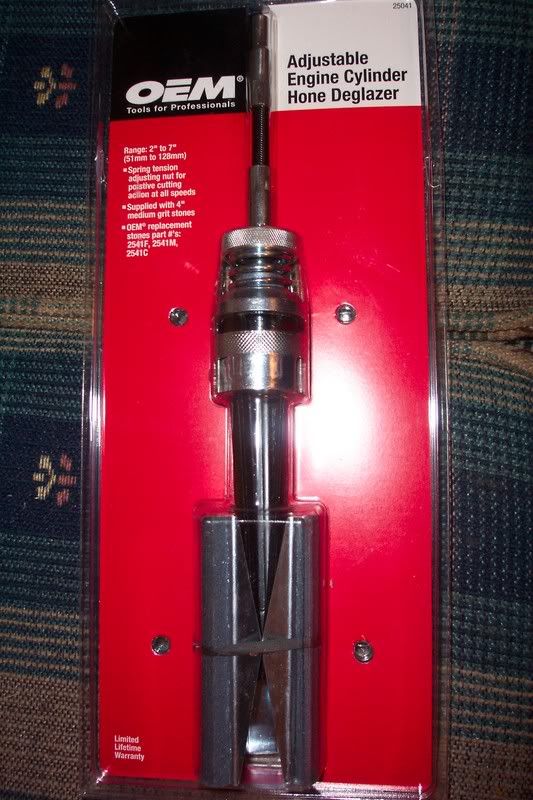

what about this DooJigger?hahah....yeah gotta use the slang...i mean come on...i'm from southern alabama....

IJ, I am pretty sure the factory wants a 400 grit stone for honing. I know it isn't in the book, are you wanting this for a clean up job?
At this point in time I could see a few people grabbing thier monitors and screaming NO DONT DO IT. I bet poor IJ bought had a heart attack. I made that mistake once man. Its a costly one.. even in a 1865cc vw :)
supramacist
Apr 8, 2006
1,501
The Grassy Knole
That tool is right up there with porting and polishing your own head with your dremel. Not to be arrogant, but I just would'nt touch that to my block.
It has mistake written all over it.
Please be carefull with it BD.

well i do have a toilet brush one but i gotta find it......lol....i figured this would do harm...but i'll keep it around in case i need to...unclog a toilet or something...haha....
