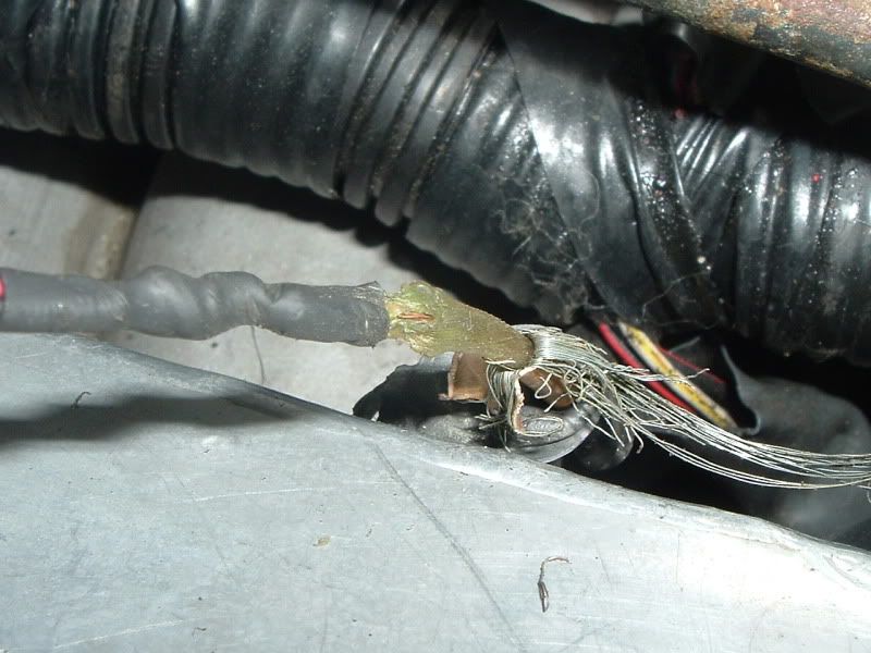

If you rewired it ***correctly***. Then pick up a couple used ones from the FS section and try them out. A new one is around 200 bones or more IIRC. Also ohm out your wires just to double check. There should be no continuity from the K1 or K2 to the ground.
I also was going to buy a new one after trying several used ones and it turned out that when I rewired it I had one strand from k1 wire touching the shielding ground wire. IIRC I had around 600 ohms when I tested it so I knew something some where was grounding out. I was lucky it was k1 so it was easier to fix and get to then k2 is.
PIC.
