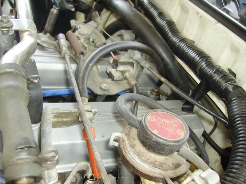

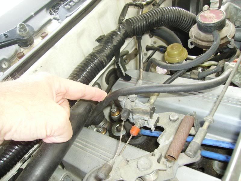

I'm running a non turbo auto with my GTE. For some reason the cable would not reach on mine neither, so I just moved it. Instead of going around the head I have it coming up from behind the head and over the linkage and it's working just fine. I don't have a pic but can get one for you tomorrow if you like.

I'll get a pic for you later when I get back home. Instead of it going up around the exhaust side of the engine I have it coming up between the back of the head and the firewall. That will give you a couple of inches to play with. You just have to be careful where you rest it over the throttle linkage otherwise you let off the gas, the pedal won't retract.
Give me a couple of hours and I'll take a pic and post it for you.

Ok, here are the pics. I hope this helps you some. Ken
