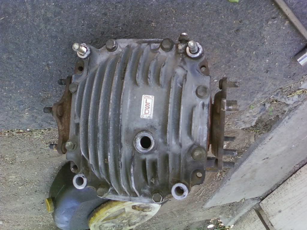

Got her on craigslist two weeks ago I've done so many thing to her to get the car set as a good dd. New tail lights did some things to the motor like vac lines and small things here and there. Just today I put a LSD I got from a automatic in my car was fun and my friends didn't even help.

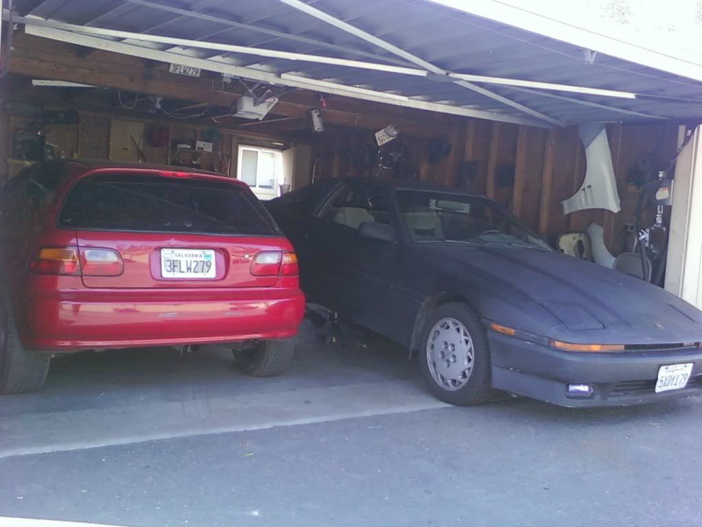

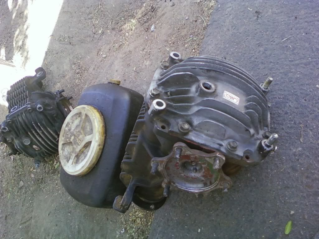

Here is my old car.
and now the boat.

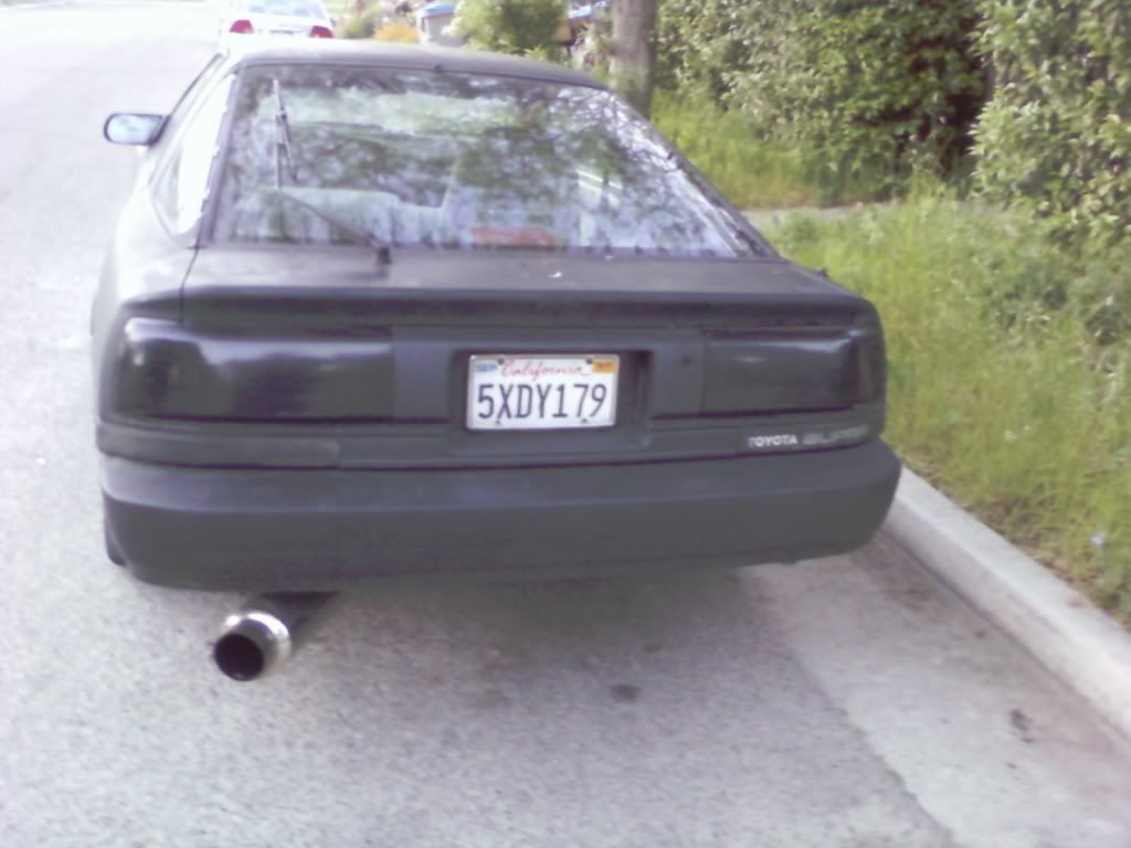

RazoE;1592578 said:
lookin' good..
glad you got rid of those hideous tinted taillights..

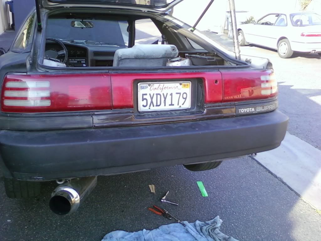

Yea the kid I got the car from did it and they had to go. So I got some goodies in the mail today.

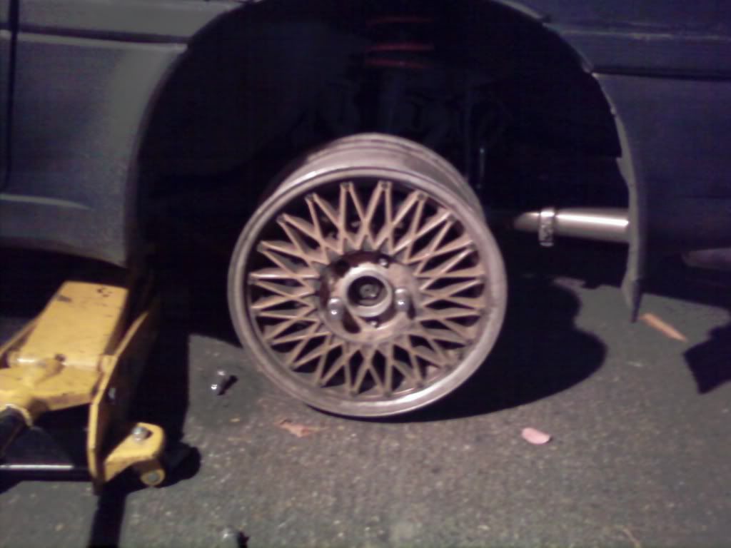

Suck a pain in the ass. The front control arm bolt was crazy long like a foot. Had to get it out of the way to get the strut out. Sucked but the car is so much better. The old tokicos that were on the car are so bad I would scrape flaps on the road.

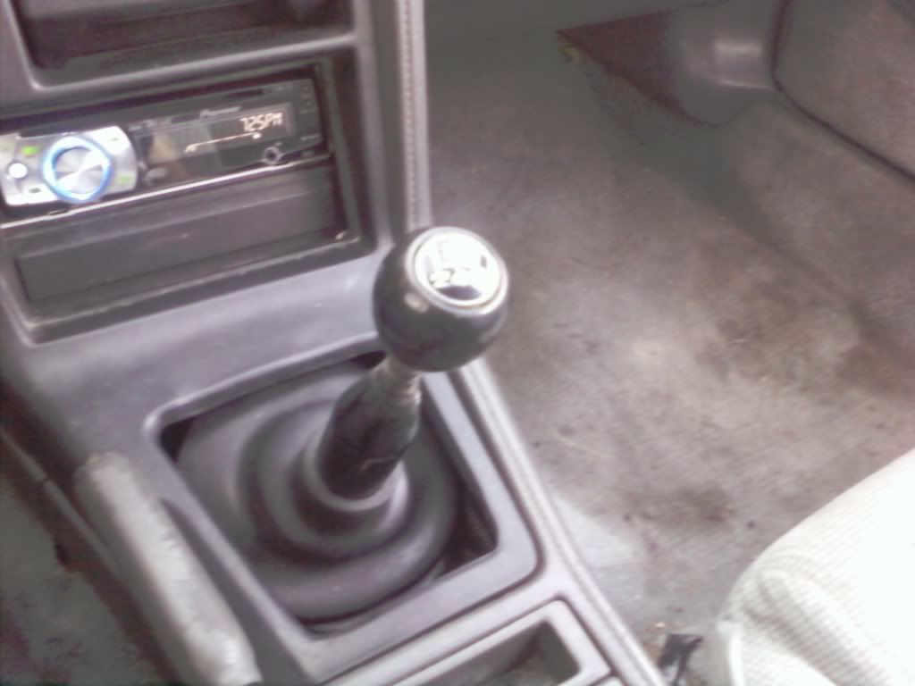

So I got some oem parts for the sifter and the shifts are like butter now.
