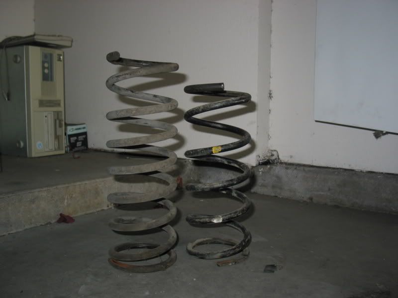

Here is a pic that shows the height difference of the rear springs, stock 87 vs. JZA70.

Don't waste your time with installing springs alone. Install the springs, and a set of your choice of shocks.
If you install the springs on the stock struts, you will be bottoming out all the time, because the old, worn-out shock will travel too far and hit the old, crumbling stock bump-stops, and your stock struts will be completely blown in no time.

They are MUCH stiffer than USDM stock springs. Car handles totally different, feels much more solid, less floaty and MUCH less body roll.
Of course I switched out my stock struts with the KYB GR-2's, and my stock ones were so blown that the car would bounce 2-3 times before it stopped. :D
