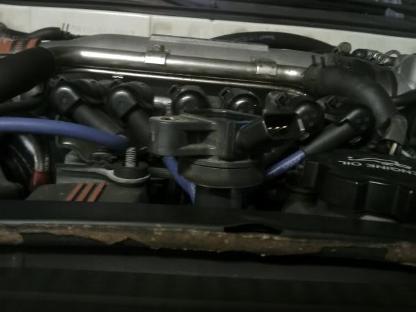

This is a 2zz coil on my #1 plug. It's about an inch taller than the oil cap.
