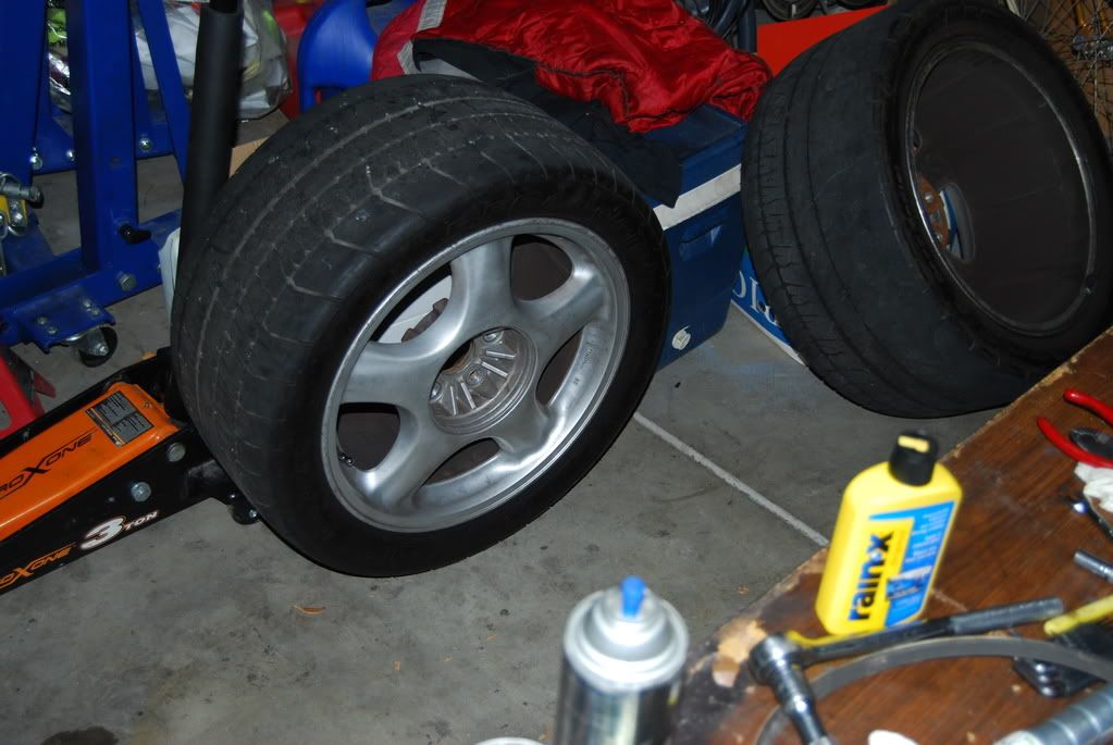

Well got the car all done runs pretty smooth just seems to still be burning off coolant that was sprayed everywhere so I'll give it a day or two to clear up with the very slight burning coolant smell.
Other note.
Got some MKIV TT rims, front are with a friend so I need to go get them up and buy a tire. Yes one tire. One of the rears was bent so I found a set of rears and now I have an extra. :icon_bigg
