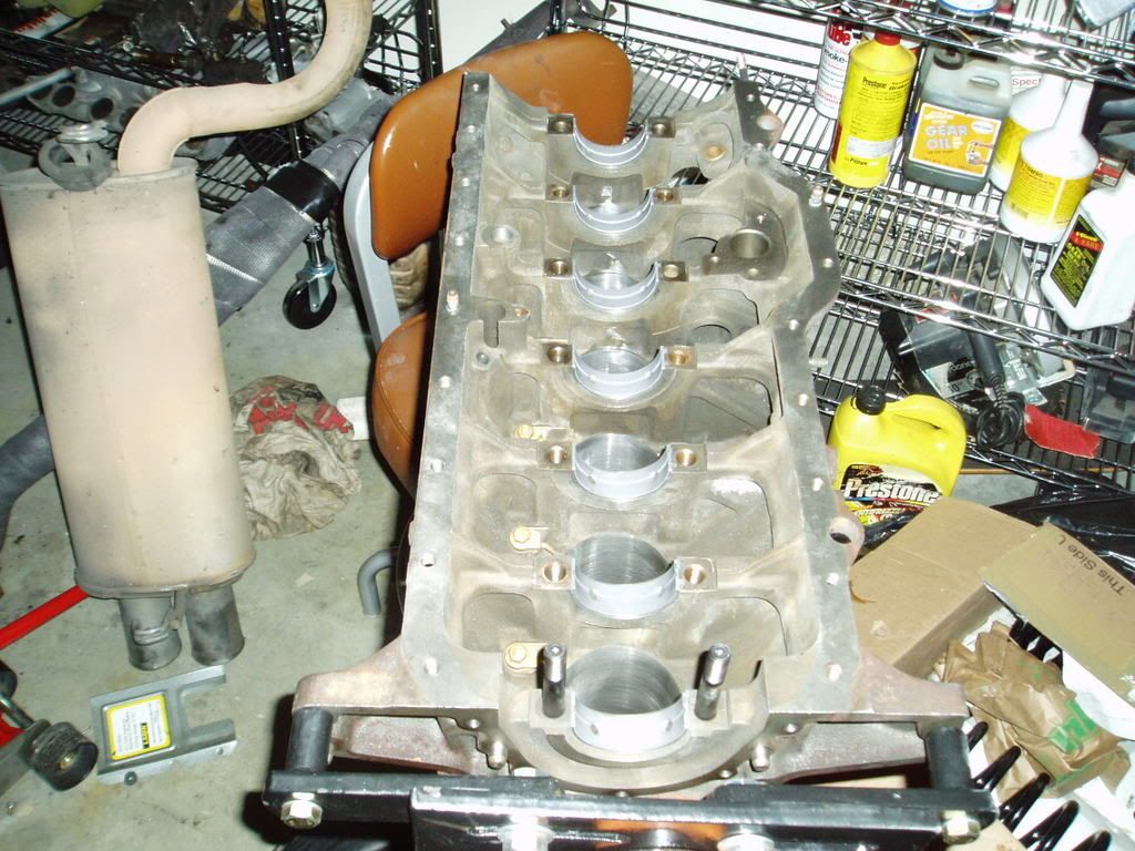

Went out to the garage today to go check the bearing clearances. I ended up finding out I need a 12pt 14mm to actually get those arp main studs off. I muscled off 5 with a wrench but I'm not quite as buff as I used to be.... :(
Well if someone(Eric) will come by tomorrow I'll at least have another person to hang with. Hopefully have the crank and rod clearances done and maybe get the block painted soon.
You're such a girl......when were yo buffed up ?? lol
How far are you from completion??
U need some muscle? i'll be on the way!

Well I can pretty much get the bottom end done, I gotta take the head in and when I'm finished assembling the bottom get it balanced. Mostly just putting everything together.
Justin come on out man it's getting to be pretty nice out here again. Take your monster for a road trip, lol. Bring plenty of women while you're at it.
JustAnotherVictim
Well after having a talk with the Mighty IJ I have found my crank was undersized. The shop failed to mention this to me when I got my crank polished so I now have a set of mains I can't use and untouched connecting rod bearings that I will be selling soon lol.
Gotta wait to see if my hookup can source some oversize bearings if not, I will have to order from another place.
