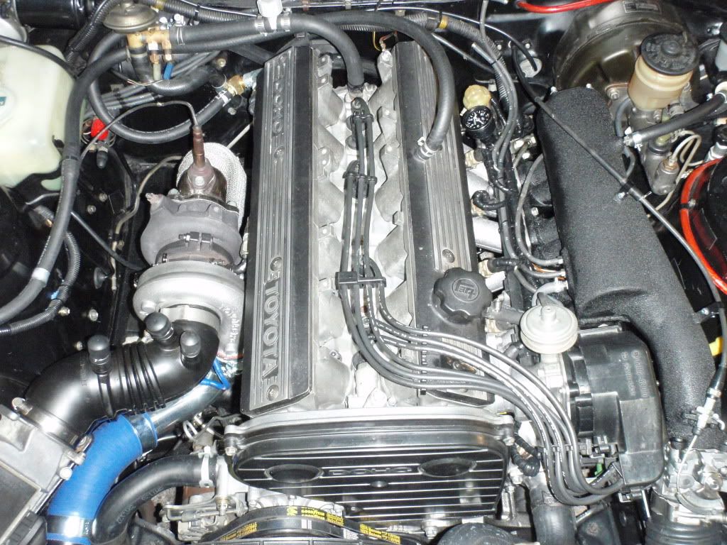

miekedmr;1438400 said:
to show you how it should be done. (it looks like it might be in an mk2 as well, maybe you should try that.)
:p
you have no idea what i've done, and i think you don't know much about that setup as well, it sure looks nice, but its all stock ecu/engine control. stock injectors, stock ct26, all it has is a RRFPR, , with that setup, it can only make 215hp., and also, his exhaust valve cover needs to be tapped to release the excess pressure or when it runs it will leak oil everywhere
on the other hand, my 5mgte, which has EMS, is able to support 500whp. without a pretty FFIM :icon_razz
:p
FFIM on that setup is nothing but clear restrictive airflow!!!! That FFIM doesnt even match the throttle body size; the manifold is thinner than the throttle body itself. Makes no sense!
No it's not, it's a pipe leading into a larger pipe. The first pipe is the same size as the throttlebody and it leads into a larger tank.
It also makes plenty of sense as it has to go around the distributor.
