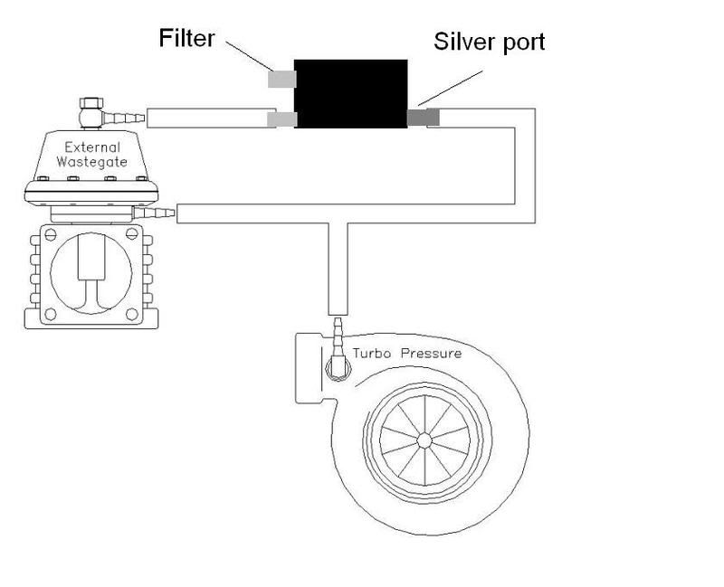

ok another question for those using the gm boost solenoid, which ports go where

got the timing down. looks good didnt sway much.
i wanna hook up the gm solenoid but i wanna make sure im plumbing it correctly.
Here's how im going to do it. Please let me know if this is correct.
