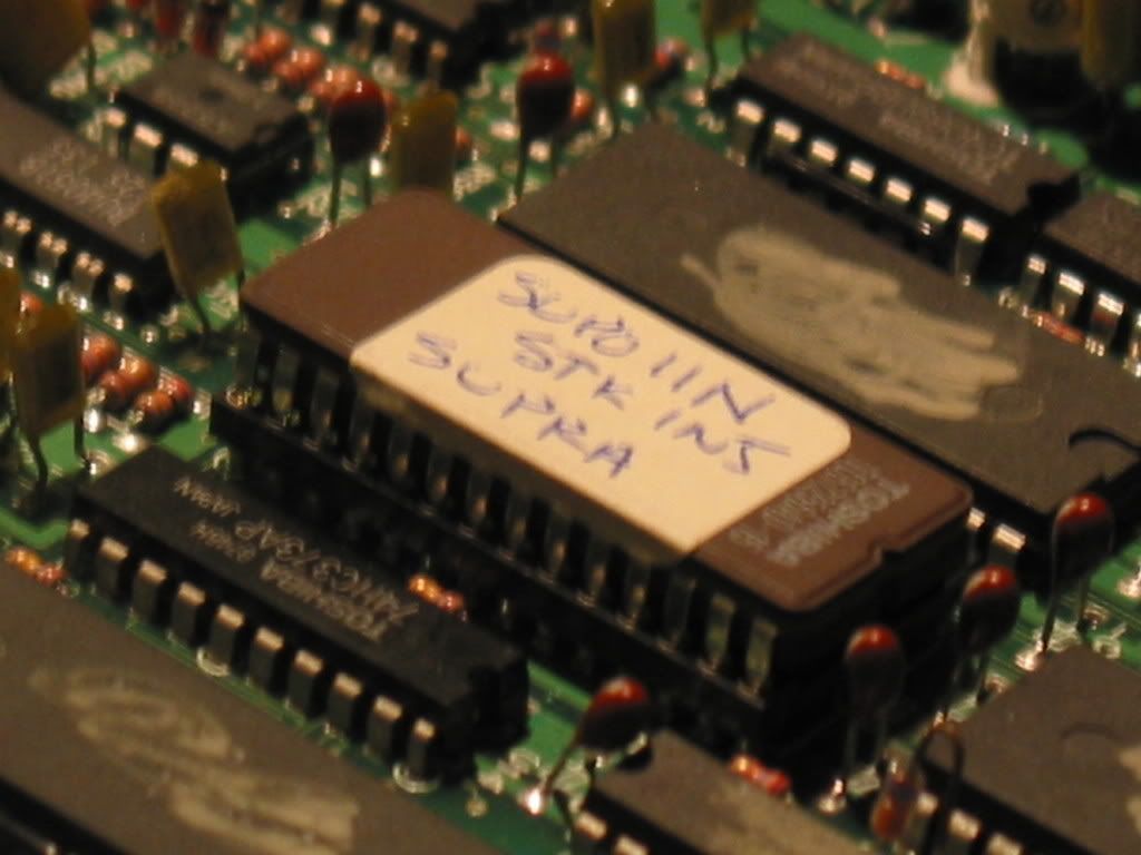

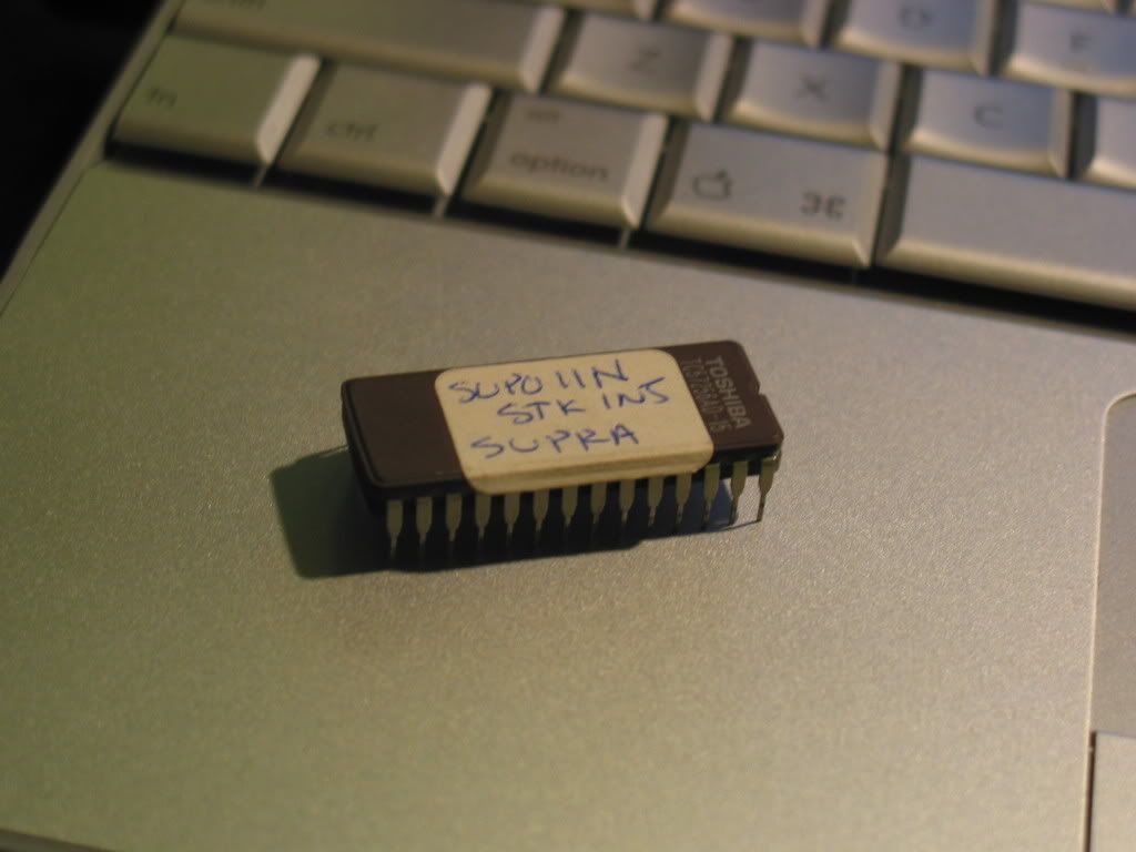

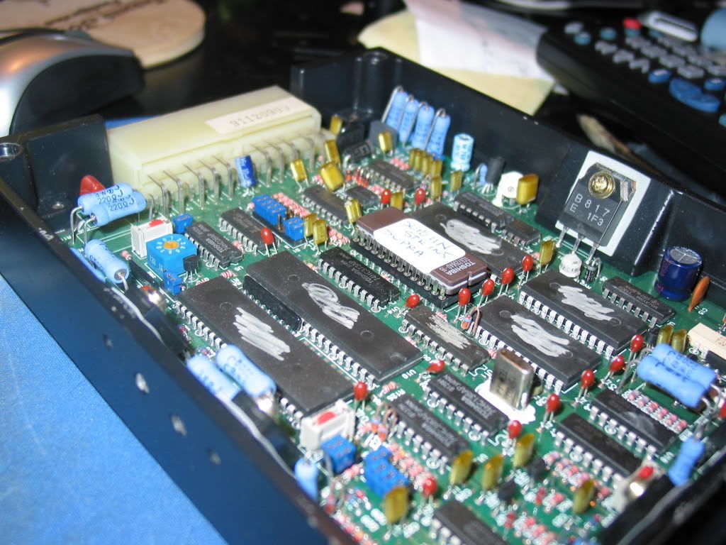

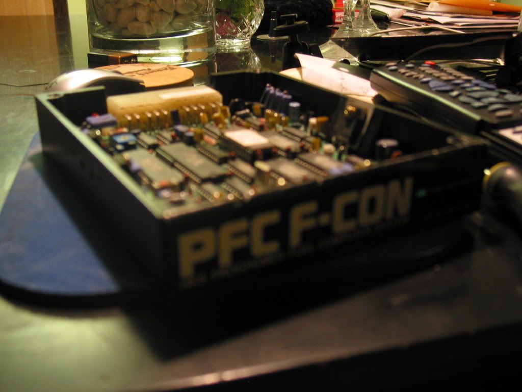

And I just got my FCON wiring harness in the mail today(TP-8 for pre-89 ECUs), then I opened the FCOn up, only to find that I have the wrong chip for what i will be using it for. :rolleyes:...I have the E105V chip (for use with VPC), but I need the E155 (for use w/out VPC).

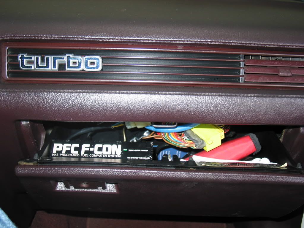

I installed the F-CON last night, I didn't have the "correct" chip, but as it turns out the VPC chip will actually work without the VPC, if you tune the A/F with the F-CON's internal switch. :)
So I did a few WOT pulls with a motec wideband hooked up, and @ WOT/12.5psi, I had an A/F ratio of 12.1:1 :aigo:...
So after adjusting the F-CON, I got it to around 10.8:1 @ WOT...:D Much better.
The chip that ended up not working (the engine would flood ever time I tried to start it!)
Installed:

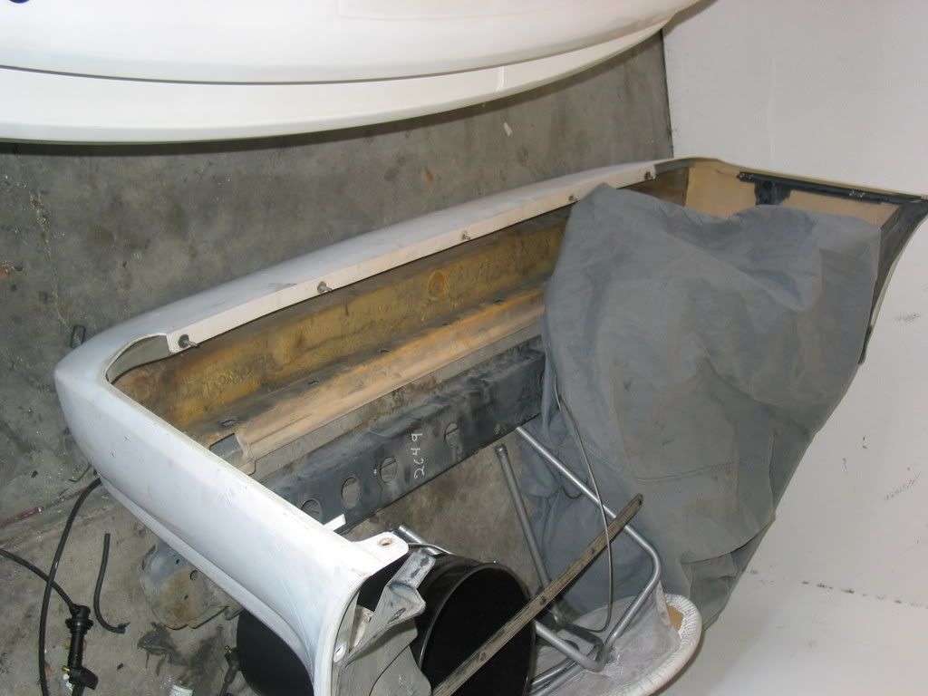

I also managed to get my hands onto a new bumper, it looks really straight, just needs to be painted!
