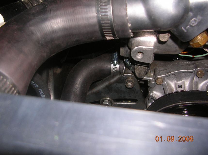

I wanted the Mustang "style" rad for the lay out, and yes it's opposite of stock. Even so, I have the lower hose coming out in front of the PS pump and not wrapping around behind, I was able to do so because the PS reservoir was moved and the mounting tab was cut off. So the flow is actually more direct. Not to mention this rad was way cheaper cost wise than a stock aluminum replacement (domestic performance parts usually are, just like the TB). And it has a little more surface area too. I'll try to get pics of the underside to show the mount I fabbed up.

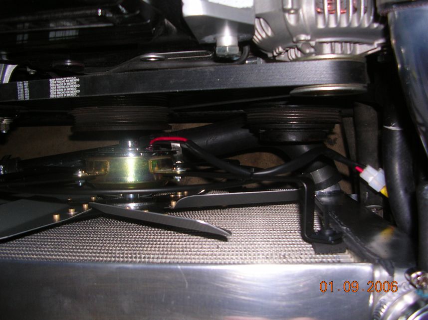

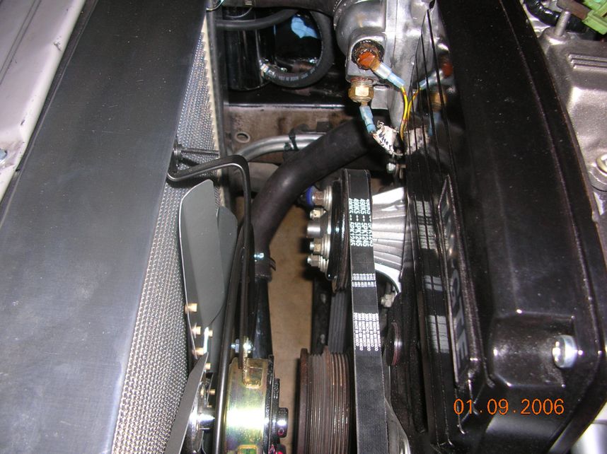

It's a cross flow rad, so the outlet is on the driver side. The dimensions are: 26" x 19" according to the manufacture, (I measured it as 26" x 18.5"). It's a tight squeeze, but it clears all the AC and PS lines running along the inside of the frame rails. It's not for a 67 (the 67 rad is smaller). It is a universal, with a mustang lay out. So it's not really made for a specific car. The only thing about it is clearing all the pulleys and belts with the lower hose. I can barely fit my finger between the AC compressor pulley and the outlet hose on the rad. The lower hose also had to be secured to the fan bracket to miss the crank pulley. I will get some pics and post them up. Here is a linkJegs RAD.

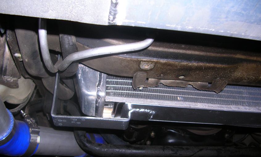

Ok here are some pics, hope these help, the lower mount is made of steel.

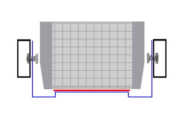

^^^There is a diagram for ya, blue = steel mount, red= rubber pad

NICE!! Thanks Jimi, that's great, and nice diagram! ;)
It seems a bit tall, though, isnt it? It looks like the bottom goes quite a bit lower than the original lower mounts, no?
I'm sure there will be no issues, though. Can't argue with the price at all!
It does hang lower than the stock, but I think the pic makes it look lower than it is. I could even move it up about an inch if I wanted to. When the fenders were off, I could see the clearance from the side, I still have plenty of room before the cap would hit the hood.

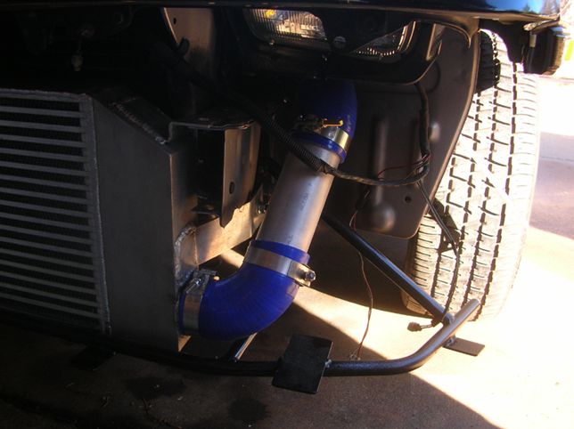

I'm actually going to build a block off/ tunnel from the bottom of the IC to the rad to help force all the air into the rad instead of going under, but as of yet temps are staying dead on, even with only one fan.
