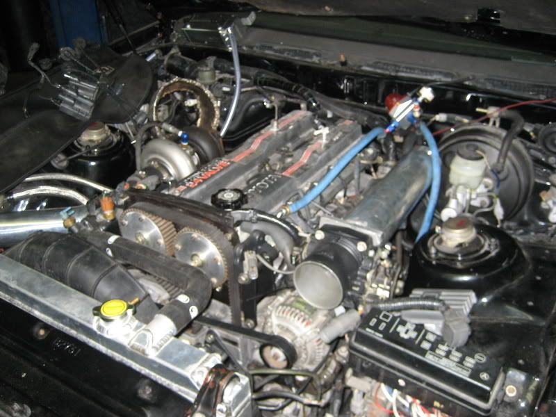

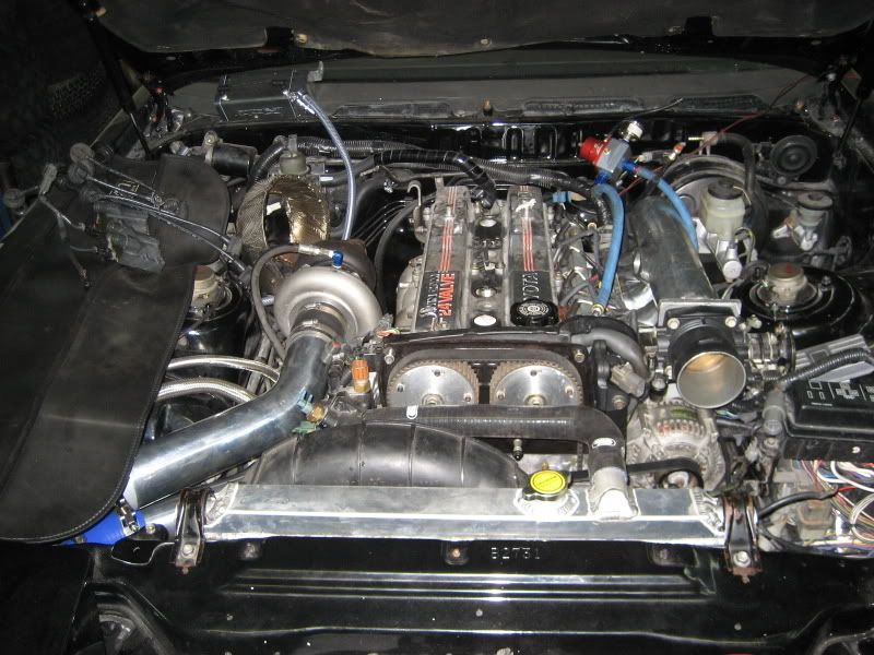

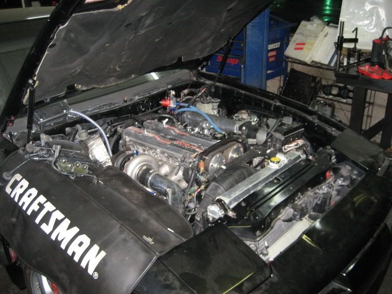

PICS! Also plan to START it up this week if all goes well.
My FORD bracket for the lower alt bracket, works with a little modification.
Oil lines done!
Mock up
