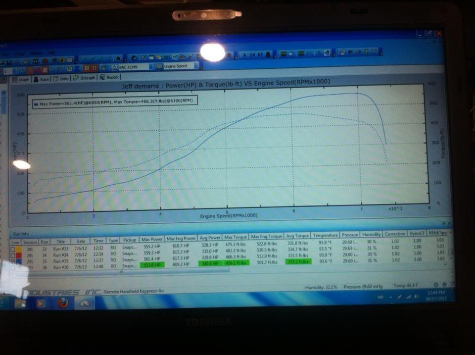

561 RWHP @ 6950rpm
466 ft-lbs torque @ 6100rpm
24 psi
94 octane + water/meth
I think i'll be happy with that for a while!
