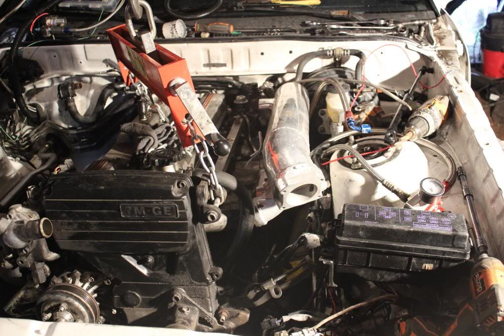

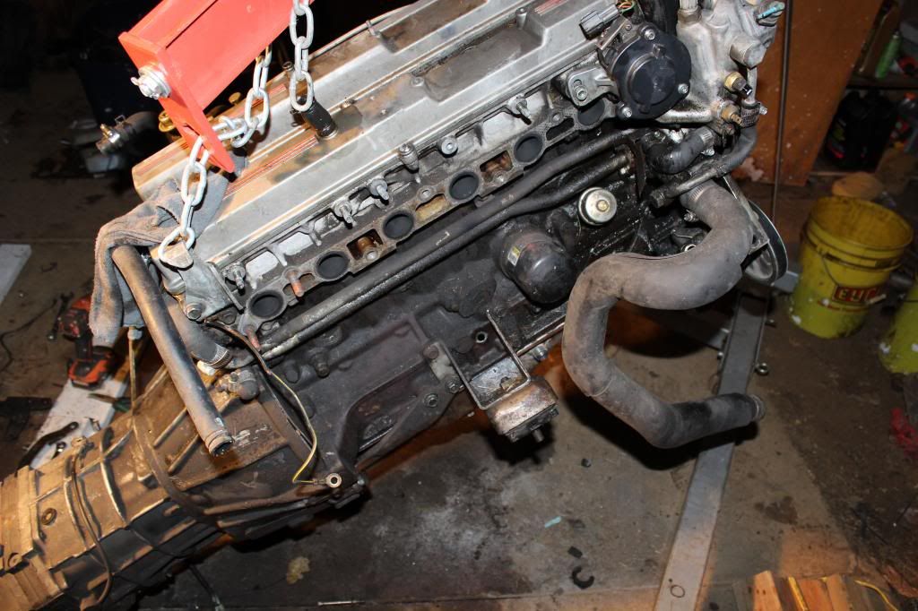

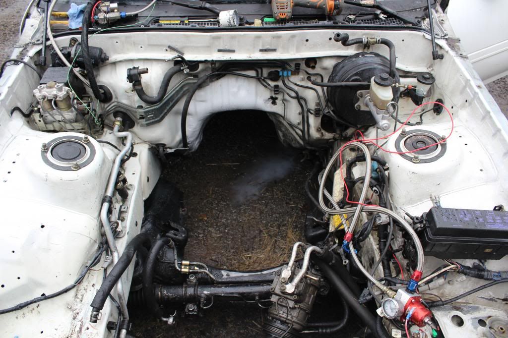

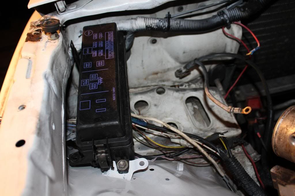

more wire tuck
fuzebox rotated and remounted
turbo
well egr cooler delete cost my buddy about 2bucks but it took sat night till 3am then sun till 11pm .....i got a little done on the supra in the next bay but i would get about 5min of work done then get called back to help him....
with ffim ill need to
get a longer throttle cable
relocate battery,need sealed box and welding leads
and finally attempt to drop alternator enough to clear intake while retaining ac......
