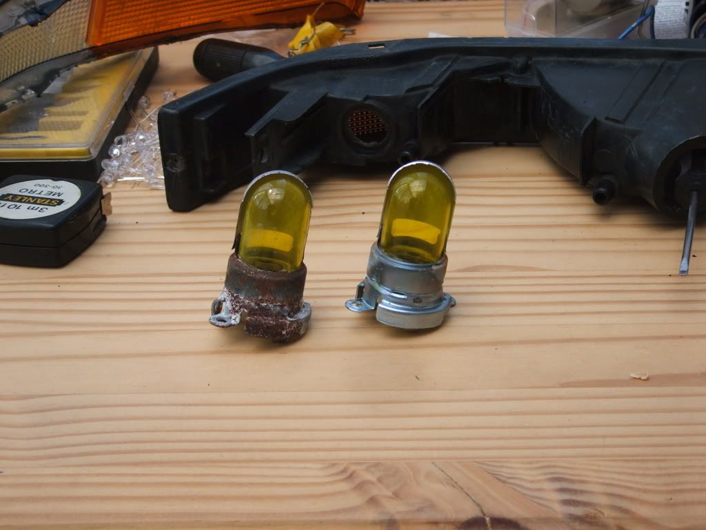

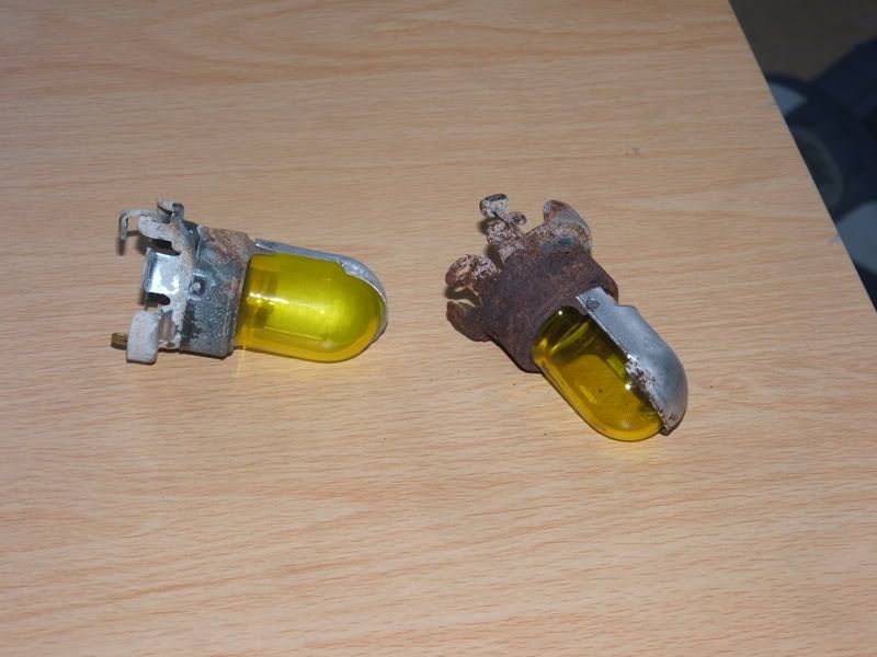

martin p;1291440 said:
Genuine JDM A70 Inserts. these were out of my Ga70. Hope this helps.
These from a JDM Ma70
Im guessing they remove the box sheild on the inside and use those reflectors on the bulb half itself. That does help quite a bit explains why the blinders arent on JDM/Euro foglamps. So then i guess its also safe to assume the blinders have to be present if those sheilds on the bulb holder itself isnt there.

those are 89+ versions, as the inserts are removable, pre 89's are removable, but not with screws, the back must be pulled out with pliers or something similar..
