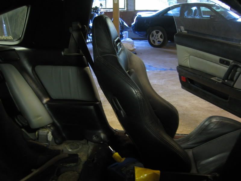

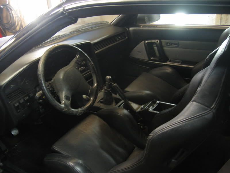

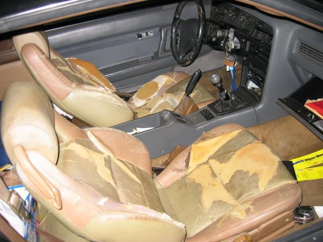

more pics.
still in the paint booth
right outside the paint booth lol
and if you havnt seen my interior

carpenter? I have spare measuring tapes in just about all of my vehicles.
Black interior > brown interior
supraGhost
Dec 14, 2007
212
PA
hah yeah actually
