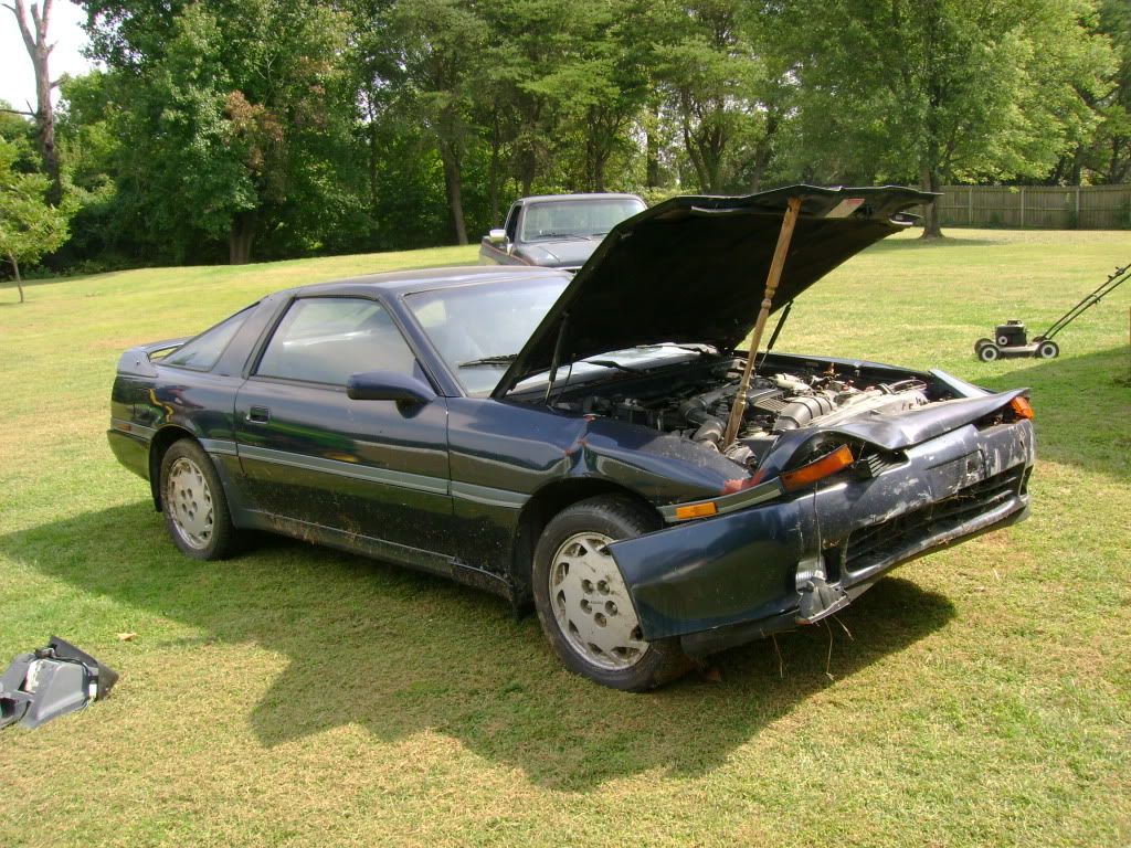

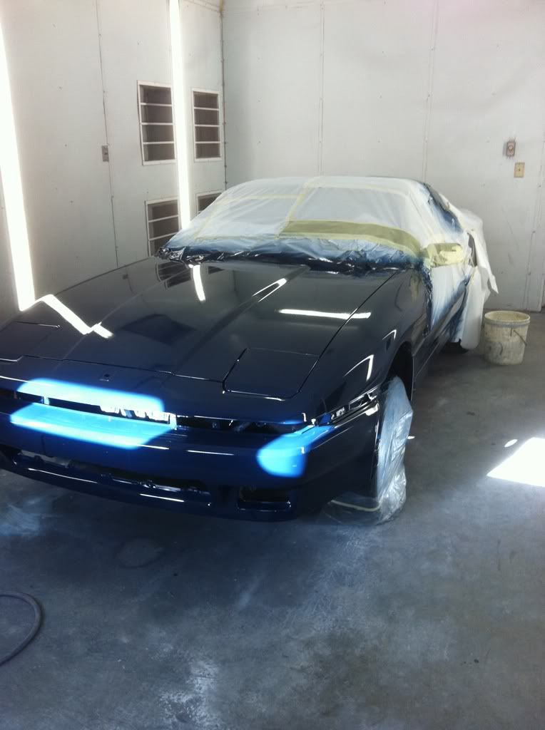

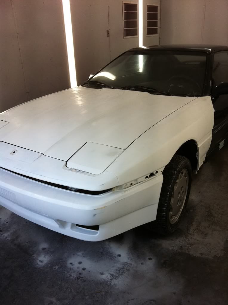

I only paid $600 for this one, turbo targa 5spd with 110,xxx miles.
Before and after I fixed it.
6,624
For that kind of money you can have better. Keep in mind, any car in this price range is going to need a good deal of maintenance addressed. ;)

And wow supra13, that is pretty good body repair you did there!
