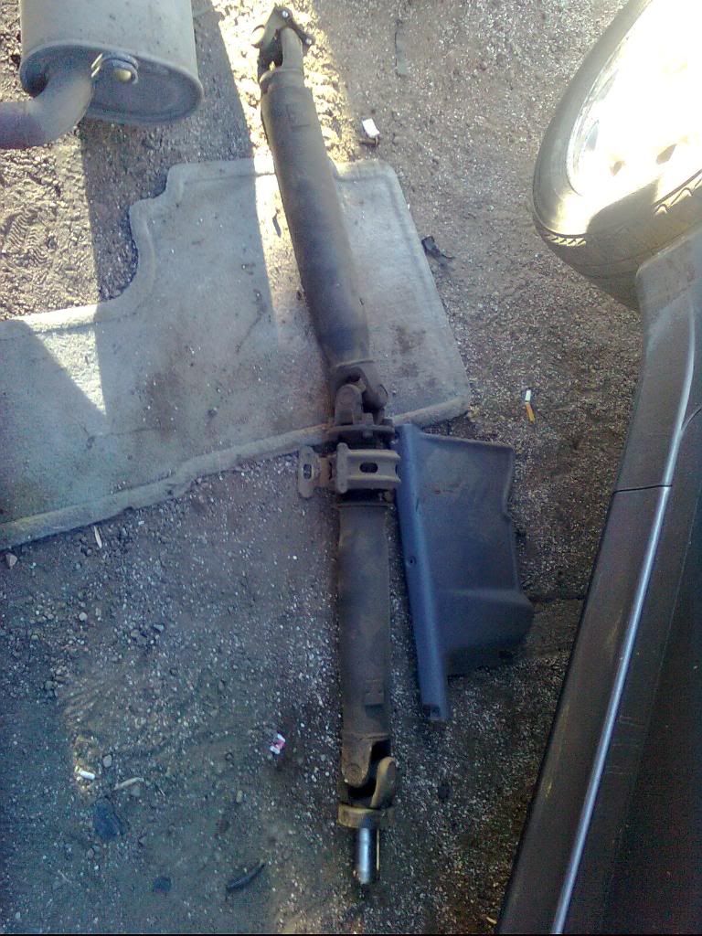

Yes the R154 spline has more teeth than a W58. heres a simple thing to help you, the clutch alignment tool that you use to align the clutch, SHOULD fit into the splined yoke of the shaft. thats how i found out if it was R154 or not, because the alignment tool does not perfectly fit into the splined yoke of the r154, its going to just spin around inside it...
