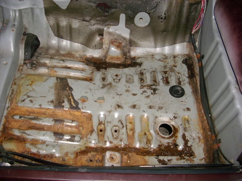

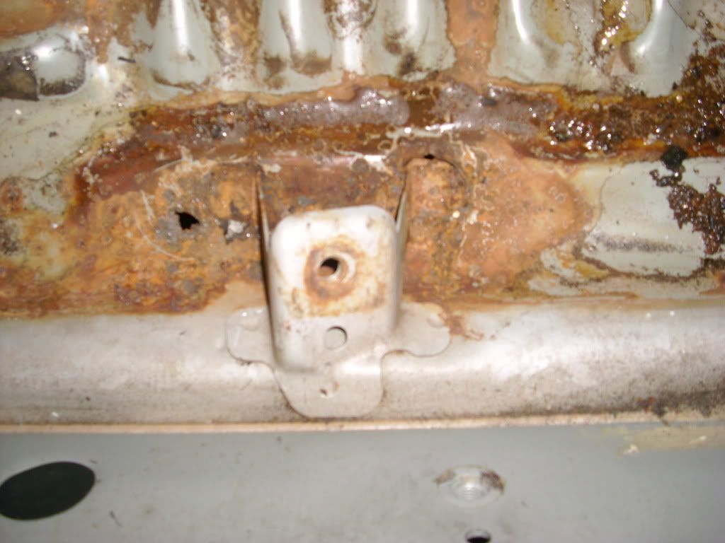

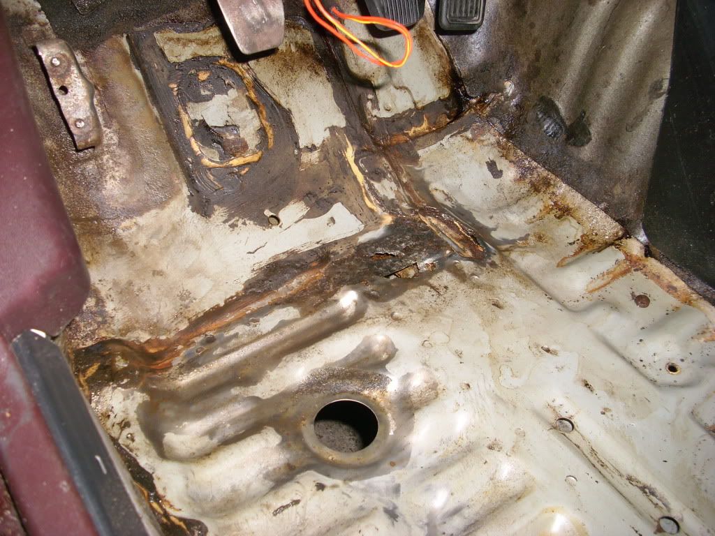

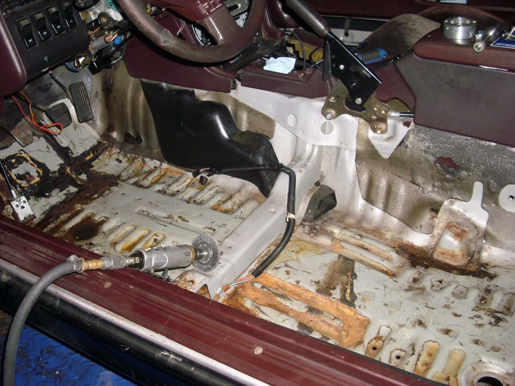

Personal opinion... remove it... if anything just to verify you are rust free, then seal it with appliance epoxy. (Its) the same coating they use on refrigerators to get that tough wrinkle finish, don’t just primer it since primer is porous, you need to seal it!
I had a leak in my clutch master cyl, had oil saturated floor carpet, under padding and sound deadener. When I was laying under the dash to service the fuse block in the driver side kick panel I had to remove the seat and carpet to fit under there comfortably. wile it was out I figured id check the floors for rust since the targa seal was in bad need of replacement. use dry ice and a hammer the stuff shatters like a potato chip
