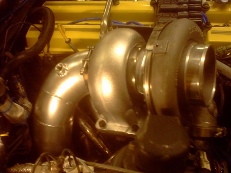

I built mine out of big rig IC piping. It's 4 inch mandrel bent pipe and the wall thickness is right in the area with exhaust pipe. I bought the flange from ATP and bothe Dynomax mufflers from Advance Auto.
Costs
4 inch Dynomax round muffler 70.00
4 inch Dynomax bullet muffler "convertor simulator" 35.00
4 inch v-band flange 40.00
building big rigs and having a TIG welder priceless.
I have had this exhaust on two different turbo set ups. My SP67 with an HKS long runner manifold and the header I built with my GT42. I started with a 3 inch v-band flange off my 67 and hand formed the elbow to meet a 4 inch pipe. It left the turbo and immediately expanded to 4 inch through the 90 degree elbow. I did the same thing for Dave B's car but with 3.5" pipe.
