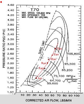

---------- Post added at 09:19 AM ---------- Previous post was at 09:16 AM ----------
Best map I could find..
