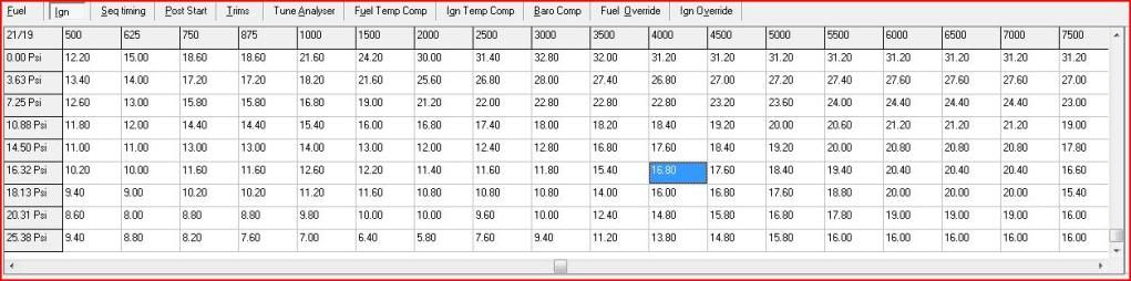

Here is mine. I think my tuner just used the startup calibration ignition map and just slightly changed it. I'm sure it could use a lot of work still.
Edit: 91 octane tune supposedly

redhot, thats a good chunk of timing for pump at 200kpa or 15psi or so from my experience with the stock maps.. was it steady state tuned with some sort of knock detection? det cans or something perhaps?
To tell you the truth... The guy who tuned my car does a lot of chip cars and is really good at those. However, I don't think he really knows AEM that well.
I have changed the tune a lot since he has messed with it. The knock detection on the aem isn't all that great IMO. My engine is very noisy even at no load, and aem seems to pick it all up. As of now it is off, and I am going off of most of the timing I was given through the tuner. I have decreased some area's at first when I thought it was knocking, but It didn't really change the outcome of the knock volts. I have also pulled the plugs and checked for detonation signs and there were not any.
Car didn't make much power and was tuned on a dyno jet. There were a lot of settings that should have been messed with that the tuner just didnt know about. After quite a bit of tinkering the car feels like it makes a ton more power. I will have to dyno again to check. Is there any other kind of knock detection method available?

After looking at some of the other timing maps, I am a little worried about mine. I am going to pull plugs again and see how they look. I'm going to check my timing sync as well and make sure everything looks right. Perhaps the startup calibration is pretty worthless to even start with as far as timing is concerned. Thanks for the heads up grim.
