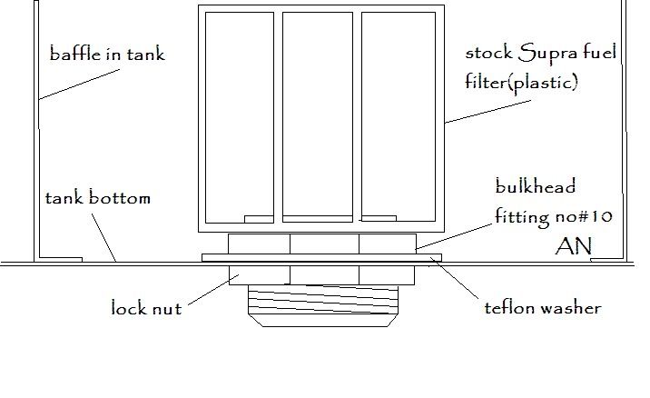

I built the bracket. I used a bulkhead fitting that was a male no#10 AN on both sides. The one in the tank is trimmed down to about an 1/8 th inch above the locknut and chamferred inside. I used a stock Toyota fuel filter off a stock Toyota fuel pump for a MKIII Supra and modified the bottom of it by trimming off the mounting tab and putting a 7/8" hole in the bottom of the fitler so you could screw it down on the 1/8 th inch of threads I left sticking up.
Here is a quick drawing.
Like Bryan said I would put a voltage controller on it for long periods of time. I have driven mine for an hour to an hour and a half non stop but never any farther.

Thanks Sean... Nice diagram... Sean, the bosche external that I was using had a voltage regulator, I think it was anyway... It was a little black box with connectors on the back, one was a ground, one went to my fuel pump, I think another went to the "key on" ignition and the other went to the battery... Is this what I need? Can I reuse that?
