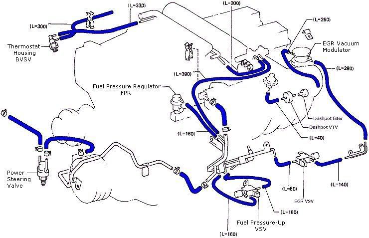

Devin LeBlanc
Apr 7, 2010
1,830
34
Las Vegas NV.
Hopefully this will help

yeah my 9 inch fronts with potenza'a arent easy to turn. i am all for fixing the power steering as long as i dont have to dump a whole bunch of money back in and for only mediocre results
thanks for that diagram. that is way useful.
on that power steering valve only one side is hooked up. your diagram doesnt say where the other side goes.
