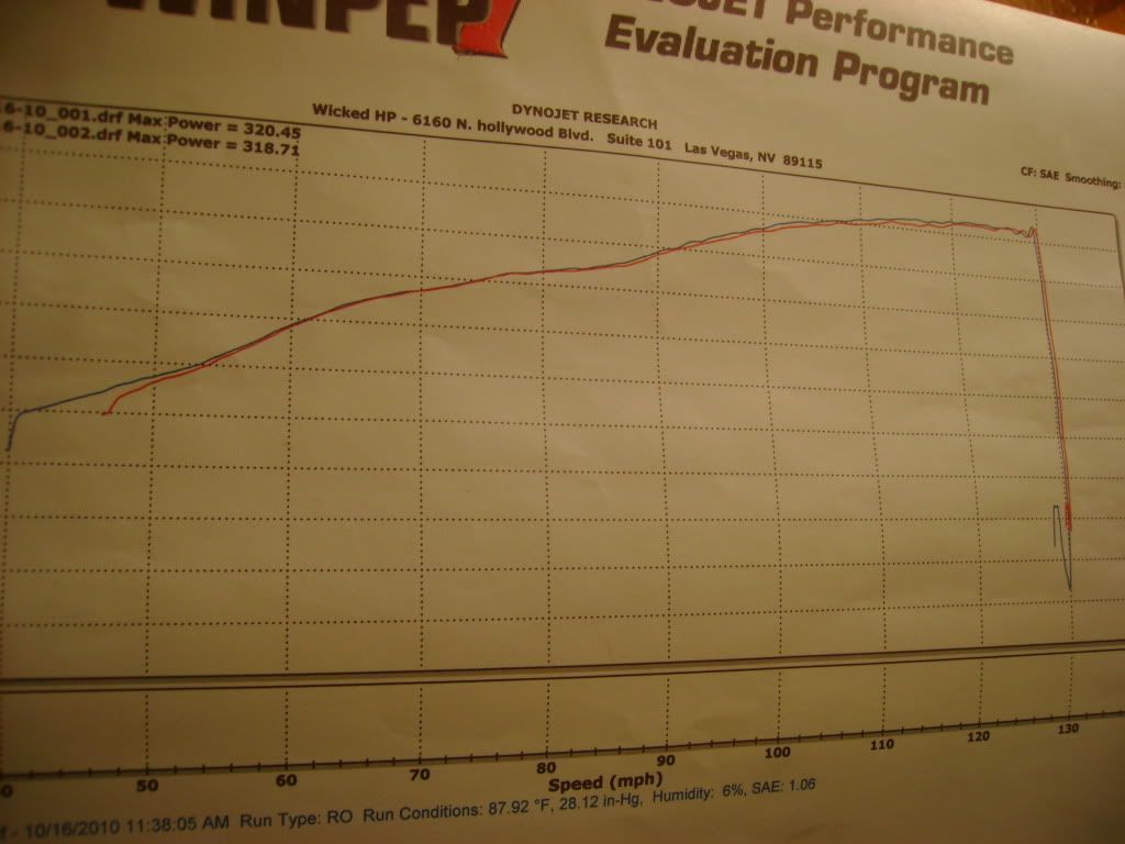

Maybe this will change your mind?
320rwhp at ~12psi. Stock intake, only mods were a 3" y-pipe and exhaust, the cams, and the porting. Even still had the silencer in the exhaust. And it was only run to ~6300 by the dyno operator for some reason.
What do most 1j's lay down at 12psi? Around 280-300rwhp?
For what it is worth, I start spooling the twins around 2000rpm at 6500' elevation. Around 2000', it's hard to tell since it happens so quickly. I'm a believer. :)
