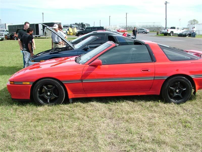

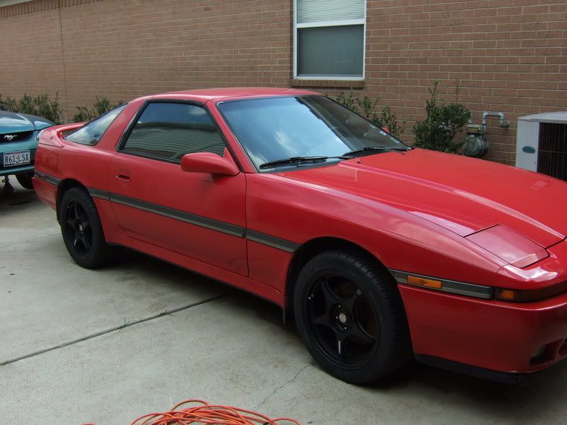

Full Zaino job done on Steven89's Supra
Before
After
Supracentral
10,542
12
1995 original paint
189,000 miles
Zaino Products used:
Z-18 ClayBar
Z-7 Show Car Wash
Z-2 PRO Show Car Polish for Clear Coated Car Finishes
Z-5 PRO Show Car Polish for Swirl Marks and Fine Scratches
ZFX Flash Cure Accelerator Additive
Z-6 Ultra Clean Gloss Enhancer Spray
Z-16 Perfect Tire Gloss

That turned out real nice. How long has it been holding up? After I read up on these clay bars, I'm sure I'll end up getting one and working on the spots that still need some work.
FYI, my car looked much, much worse than that red one. No gloss or shine was showing anywhere.
