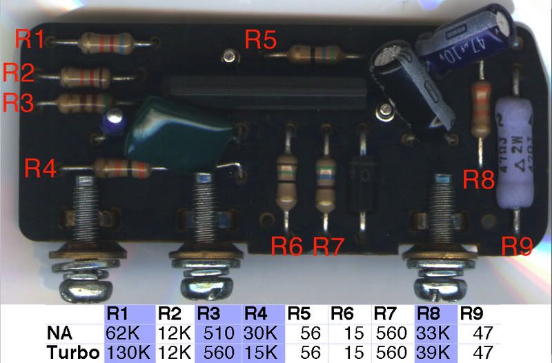

Or get a turbo tach.
P.s. has nothing to do with harness/ecu and its the igniter/ignition differences for the reason the tach doesnt work.

Does that help?
It's a small circuit board on the back of your factory tach, inside the instrument cluster.
It's a relatively easy job, even for a novice.

Yes. Or I might have some.
PM me your address and I'll send what I've got, if you don't mind waiting a few days.
Otherwise you're looking at like $7 or $8 at Radioshack.
