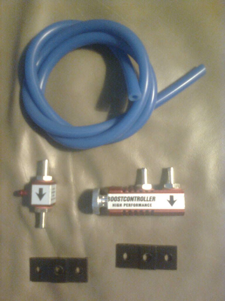

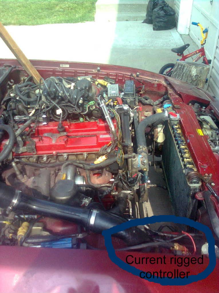

hey everyone, the guy i bought my supra rigged up some sort of boost controller...i didn't like it so i bought an actual one. lol. can anyone tell me how to hook it up correctly??? i can post engine bay pics and what not. but can i get a detailed install instruction? THANKS!

What brand of controller is the first thing we need to know. Also is it an electronic or a manual one? All you have to do for an electronic one is go onto the manufacturer's website. Also if you got one new then it came with instructions.

umm...its an ebay one. i will post pic of it in a sec. it is a manual one tho.

That one is a bleed off style valve. Hook one side of the T to one port on the knob unit, then hook one side of the T up to the boost source and the other side to the wastegate.. Leave the other port on the controller open. Good luck, these types of controllers cause bad spikes and not very accurate control

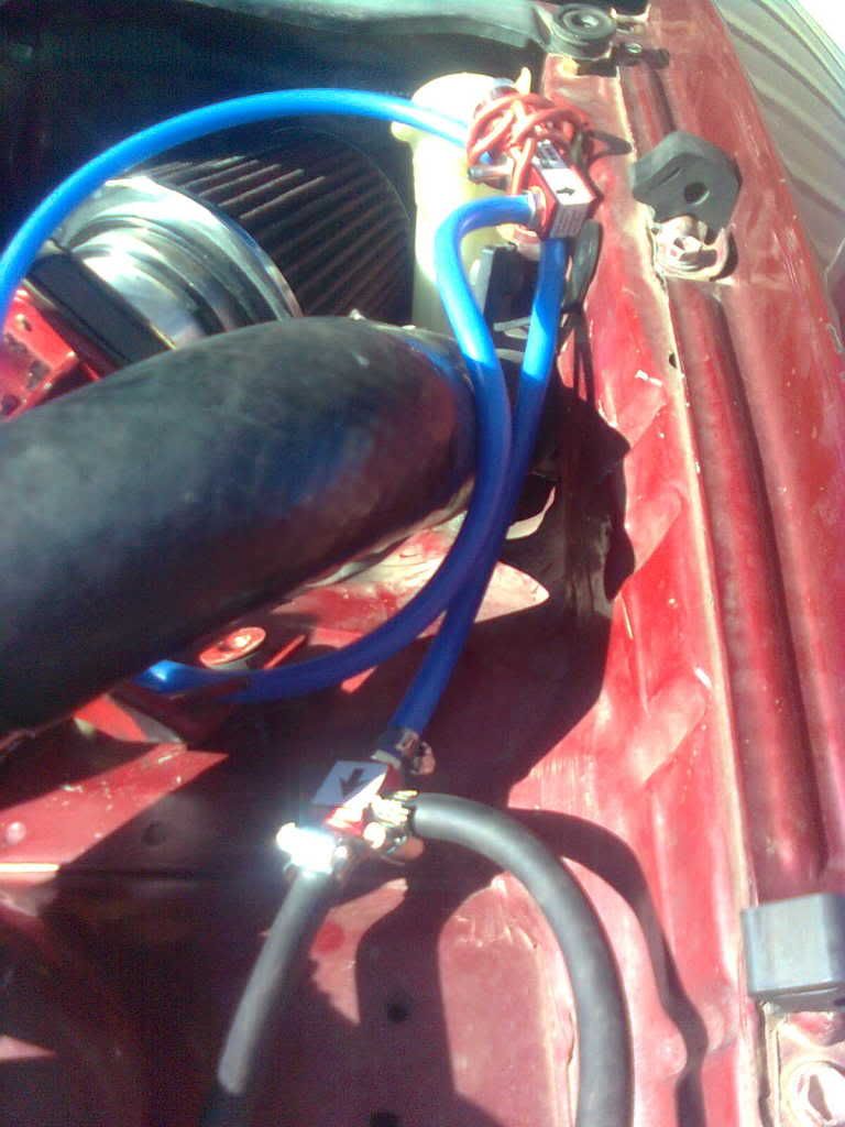

well thanks for the help it's already on there. it helps make the car driveable now. i have it turned down as low as it will go and i can actually drive it easier now (turbo is currently blown). I am not in any way suggesting that i will dd or race this car in its current condition
