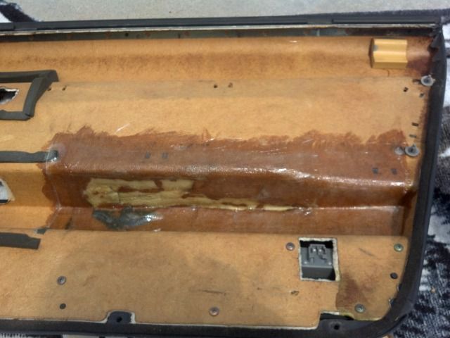

I had all the pieces in the door that broke off fall out. Now the driver door had part of the side of the arm rest punctured in so I took those pieces and epoxied them back together so that the corner of the arm rest had the original shape. (Note that all doors will be in different conditions so take what ever steps are necessary to get as much of the shape back as possible.)
Step 4: Fiberglassing the inside
I used the supplies listed above and all can be found at Walmart. I started off with mixing half a cup of resin and spreading it on the door panel to give the fiberglass resin to adhere to. The first sheet I laid down was quite large and as the layer was applied I held a flat surface on the outside of the panel so the fiber would cure flat. The following 4 layers were the size of the arm rest and then covered with another large sheet the same size as the first. I used approximately 1/4 cup of resin per layer of fiberglass. I was a little excessive with the resin because my paint brush cured and I was not able to press the resin into the fibers efficiently.
