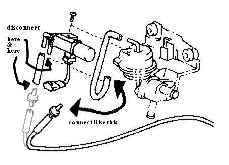

I am wondering how much vacuum in/Hg is need to pull up the hot water valve so coolant flows thru the heater core. Mine will not pull up even after bypassing the VSV. Right now I have around 12-14 in/Hg on idle with my 272's. I know it is lower than OEM but is it too low not to open the valve? I can manually open it as well as "suck" it open when I use me as the vacuum pimp. (yes I tried to word it so it doesn’t sound sick the best I can).
Does anyone know where in online tsrm this is located at?
Pic bowered form SOGI

Even though your valve works fine your switch might be bad, it's what lets the vacuum get to the valve.
Try doing this to see if it works just to check, all your doing is bypassing the switch so you always get vac to the valve.
EDIT: sorry I just realized you said you already tried bypassing.

I tested this awhile back and from what I remember it didn't take much to start to open it.
10 in/Hg or so. I would go test it for you, but mine is in storage.

Valve is still in and working fine now JJ ;) Just needed a little TLC, cleaning, and to find a vacuum line off under the CC. Also I seem to be getting better vacuum inHg now since there is a little over 600 miles on the engine now. Idle is around 15 inHg and crusing down the free way around 28-2900 RPM's it is 18-19 inHg.
