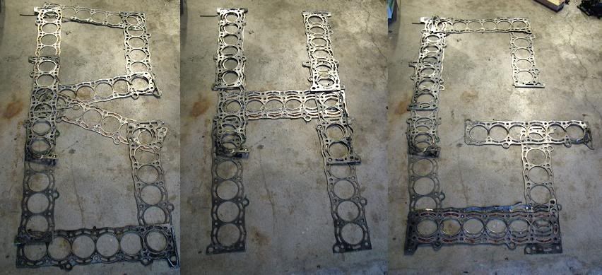

I dont want to base my engine's lifespan on luck. I fixed all those bhg's in the pic, plus more. If you have been around 7m's for a while you will eventually think the same way as me. Oh yeah, I have two more jobs lined up to fix bhg's as we speak.

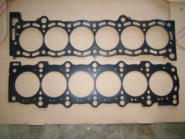

The mk4 has a METAL stock headgasket, Toyota changed to metal headgaskets after they had lots of problems in the late 80's, early 90's with headgaskets on several models of engines, not just the 7m. Here is a 1jz hg next to a 7m hg:
See how much more surface area the gasket covers around the cylinders.
See how they moved the coolant passages between the cylinders so the hg has more sealing surface and the gasket can't deform. Look at how meaty the jz hg is, it is almost impossible to make it deform. I still love the 7m. If it didn't have any problems then what fun would it be to fix? I love 7m's for the challenge. I know what is wrong with it and I know how to build one that IS reliable, and part of the formula is a MHG!
Just look at the 7m headgasket
1: it is way to thin in many places.
2: there is not enough clamping force to keep the gasket from deforming
3: there are more holes in the hg then there are coolant passages in the block which leads to errosion of the block and head over time.
Obviously the hg was designed for the engine, not vice versa, so I guess the engine design was the real problem that causes the hg to blow.
I will admit it.
Also notice the arrow in the 1jz hg, that is some funny shit! I guess people put lots of headgaskets on backwards LOL
