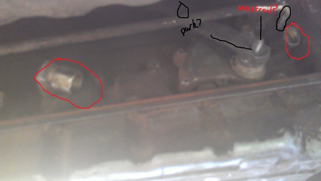

So i've been fighting my supra trying to hook up the shifter lever to the tranny
What are the 2 things in red circles what goes there?

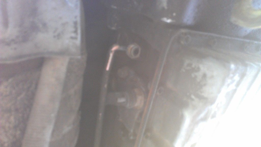

I believe here I have it in park and the shifter lever on park as well and as you can see its way off? Why cant I align the shifter to the tranny?
Something is wrong and for the life of me I cant figure it out, if someone can lead me to the correct direction I'd appreciate it. I've read the repair manual and doesn't really explain anything, I googled and nothing.

It's not that it won't shift, the shifter lever that reaches to selector on the tranny goes off way to forward and the only way I've been able to connect it is if I put the tranny on L then the lever connects, and well I can't shift lower than L so the shifter doesn't move anywhere. Then I put the selector back to park then the lever on the shifter doesn't reach anymore.

You have pictures. Here is the page.
http://www.cygnusx1.net/Supra/Library/TSRM/MK3/manual.aspx?S=AT&P=140
The mechanism reaches if the trans is installed correctly with bellhousing bolts and mounts. Don't take this the wrong way, but most threads on here are where the car was not done correctly. Double check everything looking for something that seems irregular.

I thought it was that at first (the battery not being there) but when I redid this the battery was in and still nothing and it's because I wasn't hooking up the mechanism correctly to the trans. Thank you for the link, I'm going to recheck and see why it's not reaching properly, Appreciate it
