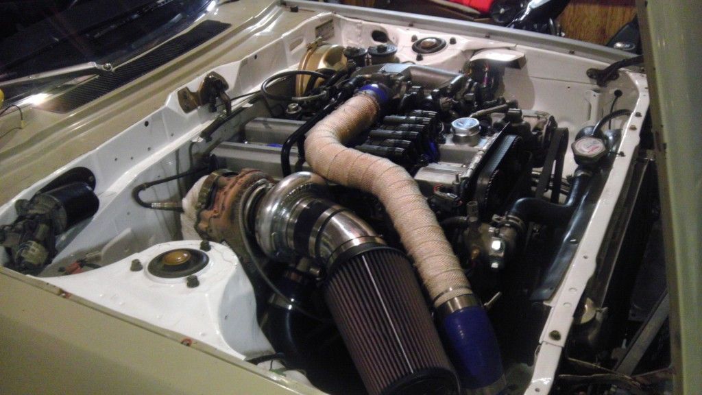

The housing will not work on a HY only an HX. This is what the BEP housing looks like on a 1jz w/ XS power t3 manifold:
