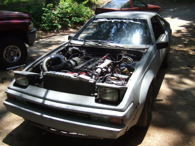

Let's just say it needs a little paint ;)
6,625
Oh holy hell man, I though you had that JZ in a Mk3... that much power in a Mk2 has gotta be a bit of a handful. Looks like you could use a hood while you're painting it too. :p

It was in the MK3, but it broke the subframe. My friend Taylor welded tank armor plating to the MK2 subframe, so I hope it holds. I hope the Jawsgear / tru-trac built diff holds up.
Hood won't fit until I redo the radiator, and re-clock the turbo. I want to replace the Greddy 3 row with a larger core before I re-clock the turbo.
Once I get ready, I'll build an LSx and put into the MK3 and show the other LSx fan boys how it's done.

Sick. FOr a second there i thought you had some stock size tires and hooking with them in the back. Couldnt see the rear tire but the front looked pretty stock.
That thing is a straight sleeper or will be when you get a hood on.

My car is too loud to be a sleeper. With just 18 inches of open exhaust from the housing, you can hear the turbo before you can see me coming.
