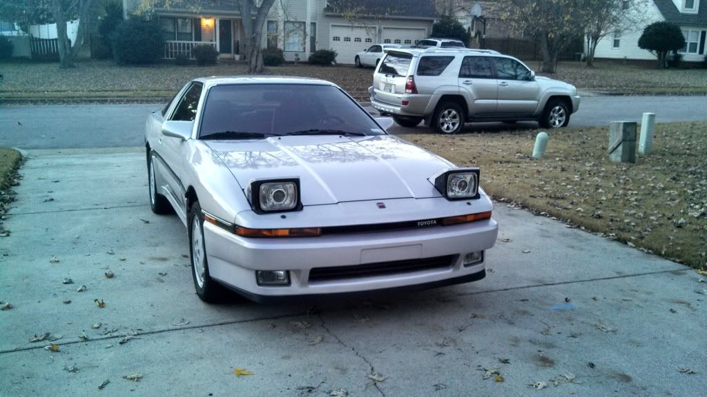

In the truck this setup was fine. And the autopal(hella) lens I had with the bi-xenon bulbs where bad on blinding traffic. The real problem was after months of use the lights when bonkers and operated when they wanted to. I wasn't sure if this was due to the magic blue box under the dash and a imbalance of power draw or what

While on the topic of HID did you power each ballast individually via the head light plug to each side or did you pull power to both ballast from one headlight plug? i got a ebay "kit" and it pulled from one plug only and soon the headlights started going bonkers(headlights go up and down,turn on when they feel like it) Reverted back to incandesant ever since.
I picked up a wiring harness from http://theretrofitsource.com - it has it's own power leads, and just uses the OEM plug for a switching signal so it knows when to turn the light on and off. I've been running it for a long time, and haven't had a problem to date.

had mine right on the side of the beside the battery and on the otherside in the same place. using 1 10 MM screw.
I've since ditched the HID's because of the shitty ballast always failing and never been happier. I'll try LED's eventually
